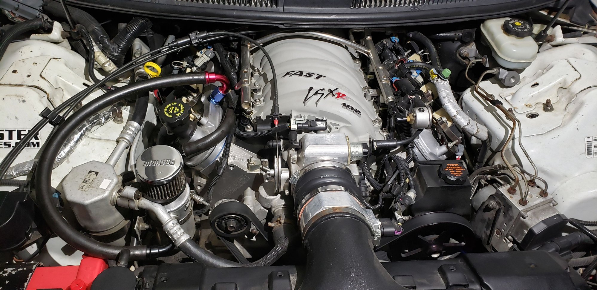

The only difference between this and the OP's is that your utilizing a sealed catch can to try and stop some of the oil/contaminants from making its way back into the intake manifold. I have that same can and was running it but didn't like seeing the oil residue get into the intake manifold so I've ran 10AN lines from each valve cover to a breather can and its working just fine on the NA 427.
Yea I know, he asked to see where I had the check valve. With this I haven't seen any residue make it into the intake since I've added the check valve.

Nothing wrong with running PCV on a street driven car, mines not a daily and I prefer this way and going back to PCV will cause issues with my tune.

I stated in my first post that's not my engine or picture lol.
I run a corvette mod catch can after the pcv valve on a stock ls1 intake. I used that picture for reference because it shows the hose I was talking about.
Thanks for the pictures and info everyone.
