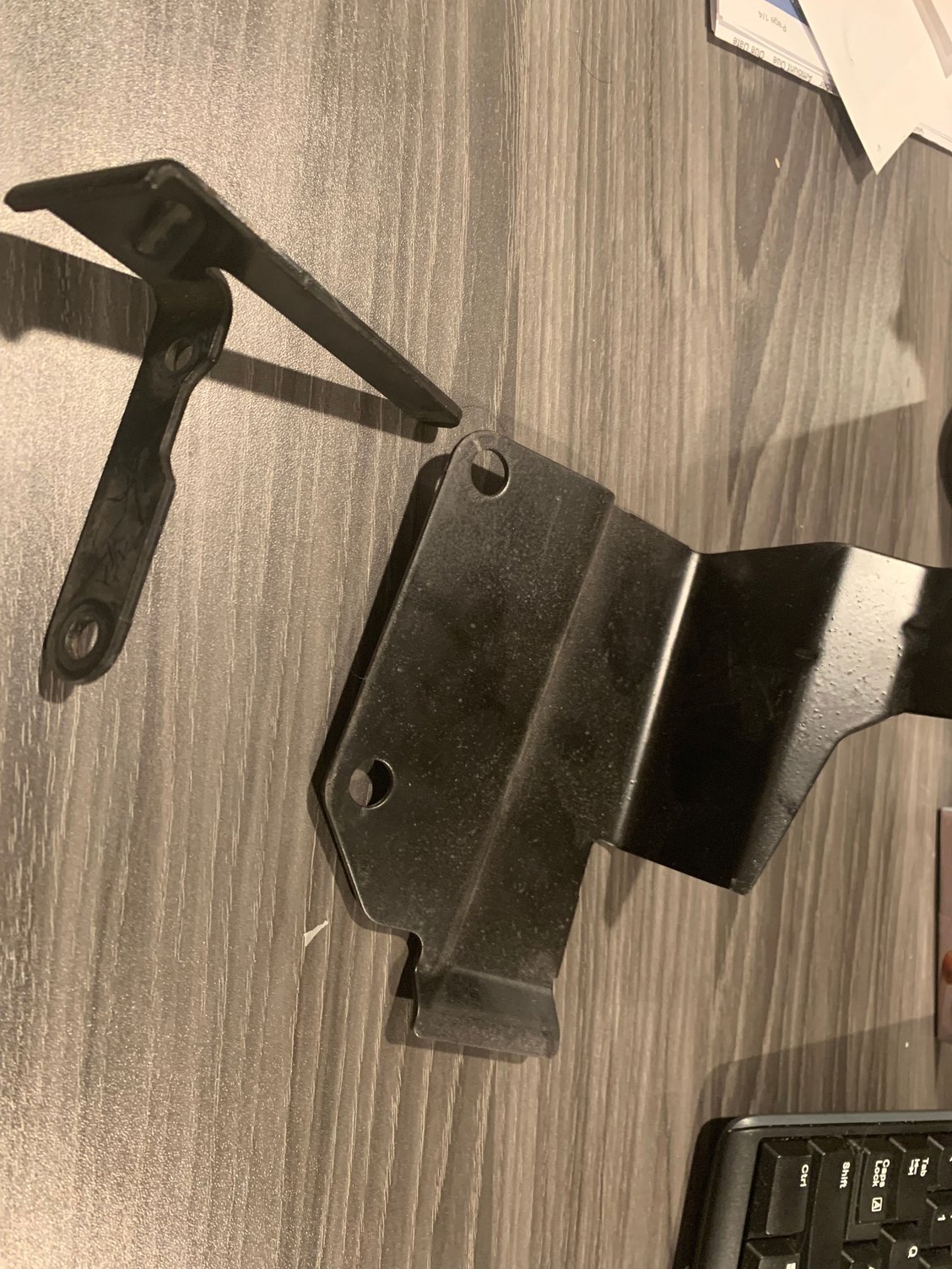

Reassembling engine bay, front bumper, electrical after an engine swap. Anyone recognize where these brackets belong or if necessary?
Unknown brackets

The one on the right appears to be the cruise control bracket.

I think the one on the left is the throttle cable mounts goes on the intake manifold right behind the throttle body

the one on the left is the fuel rail stop.....goes to the rear on drivers side ....intake manifold.....keeps the fuel rail from going rear ward in the event of a crash
the right bracket is a cruise control protector.....goes in the front inner lower drivers side fender well.....2 screws hold it against the body and one bolt goes off the stud from the sway bar bracket front bolt
