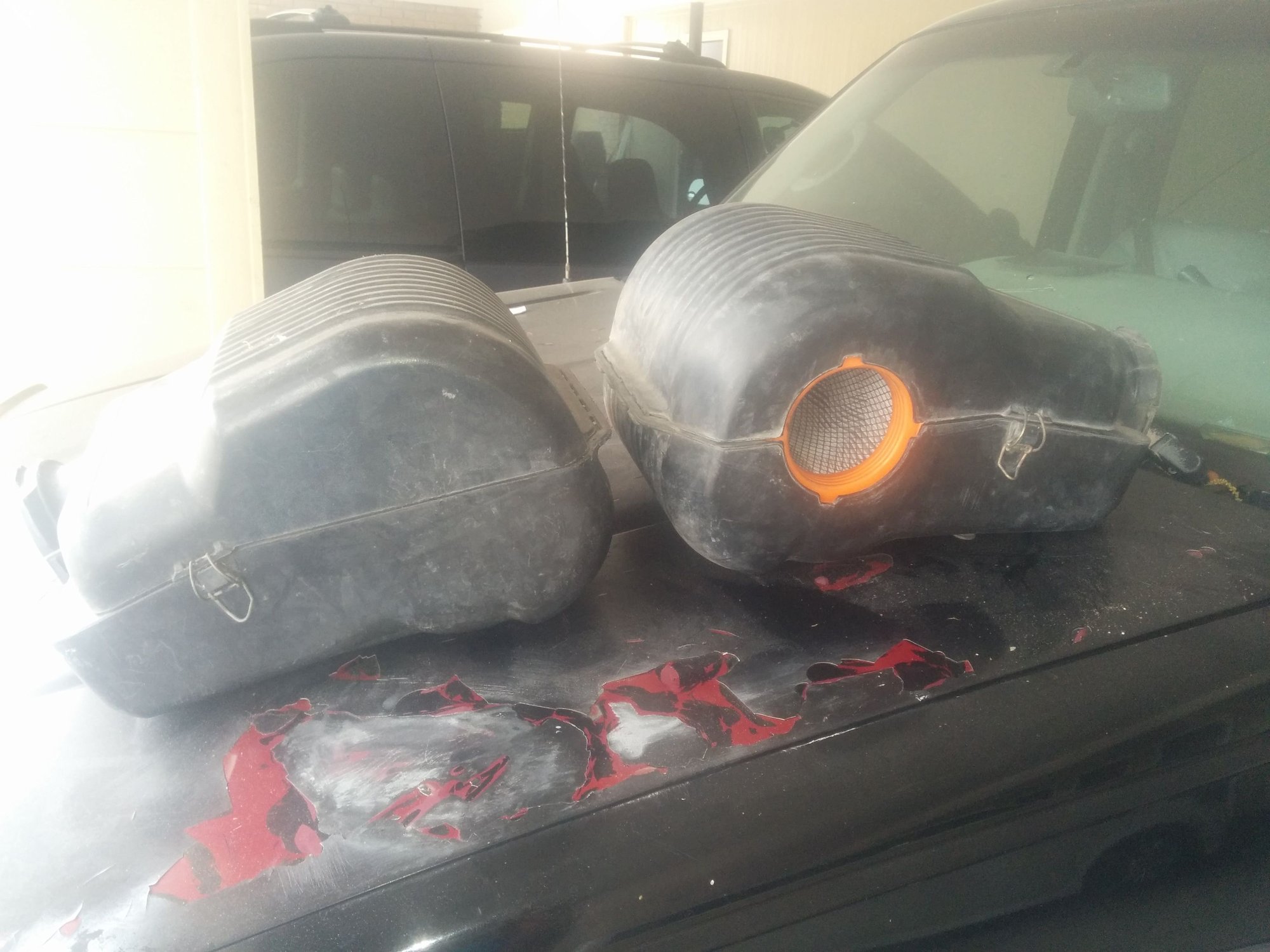

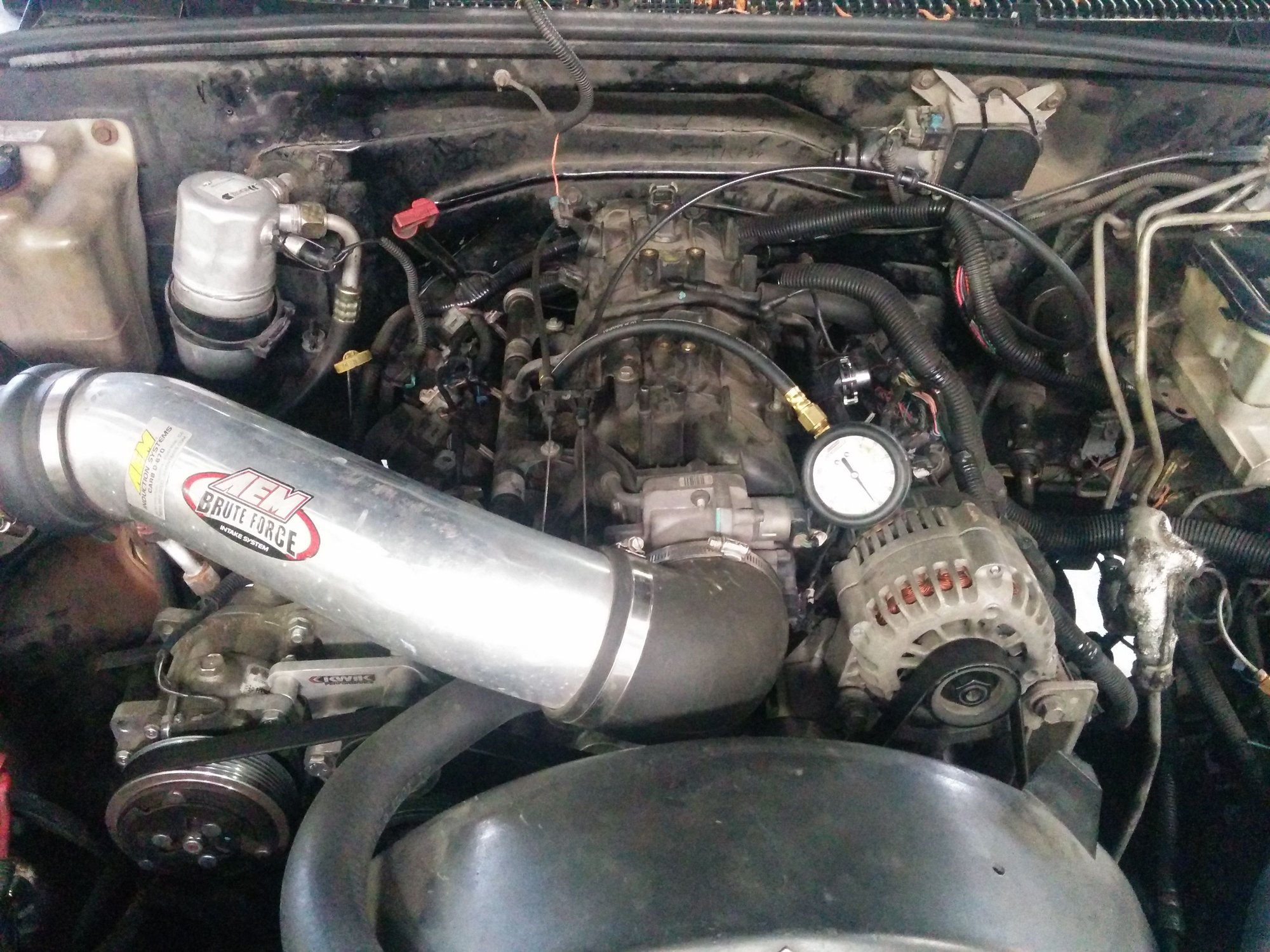

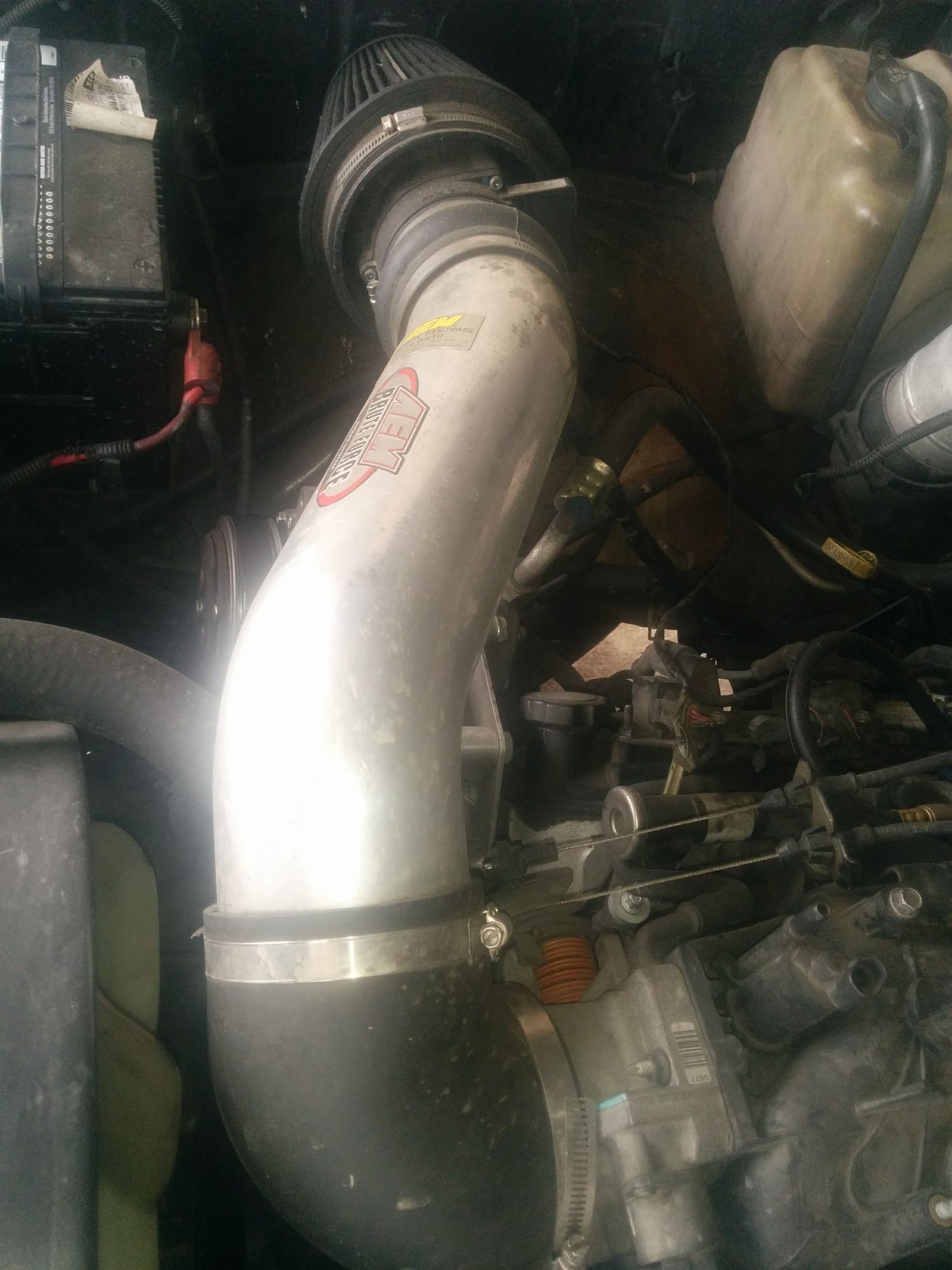

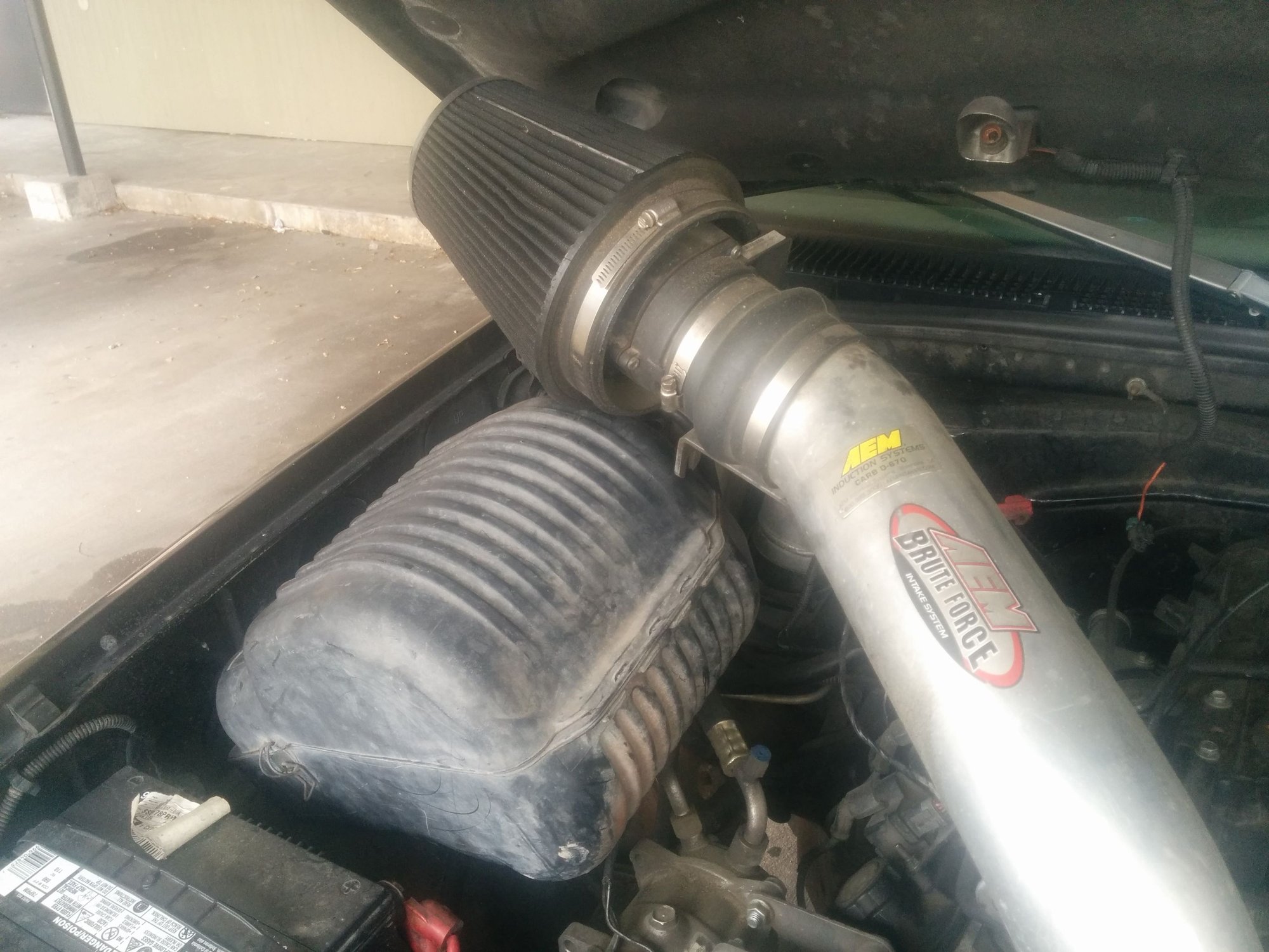

I'm intending on running my pipe back to the stock box and 'moving' the hole from the back of the box to the front of the box.
Currently I'm running a Hummer CAI that comes pretty close to lining up with that idea.
-KP

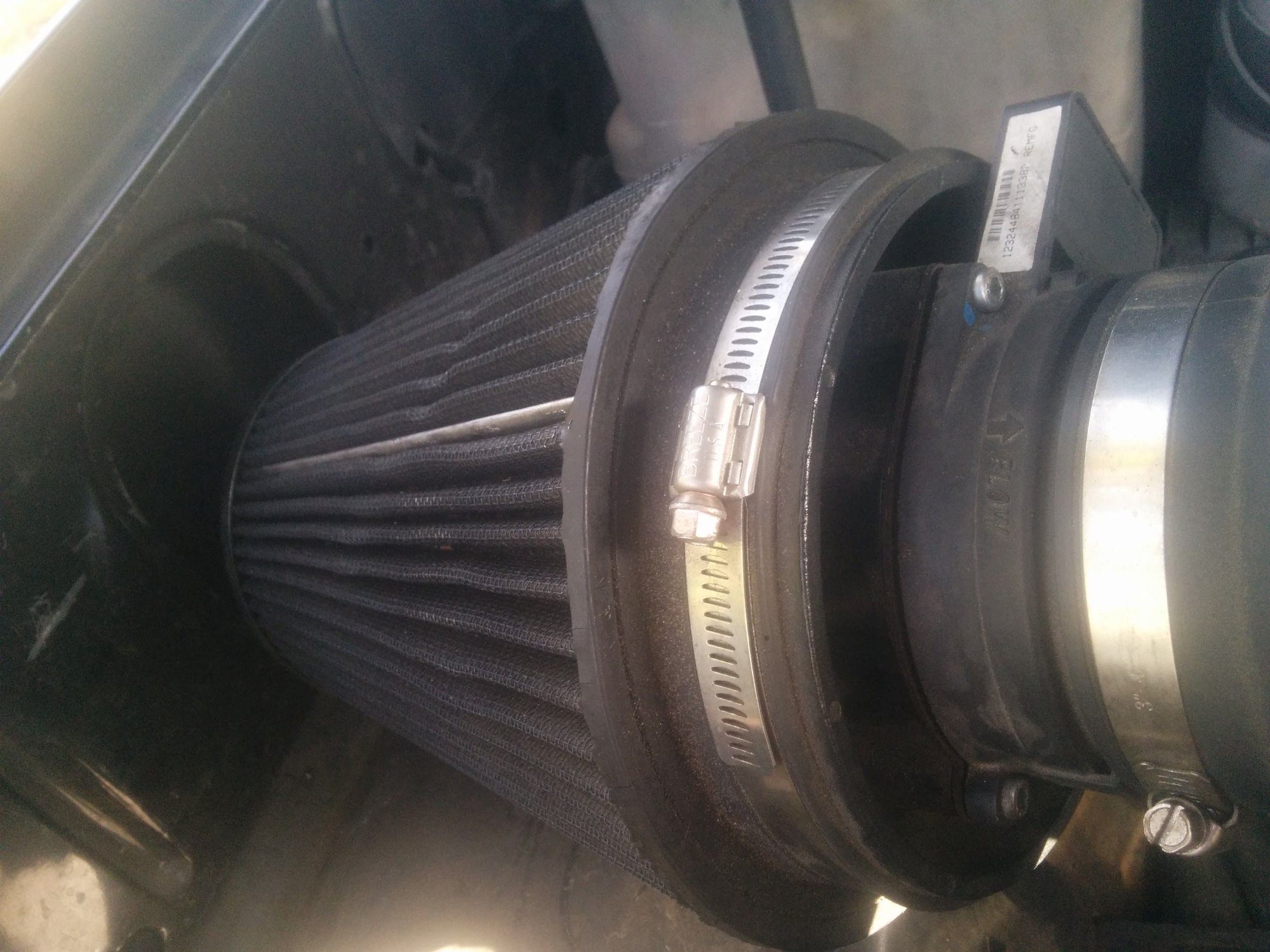

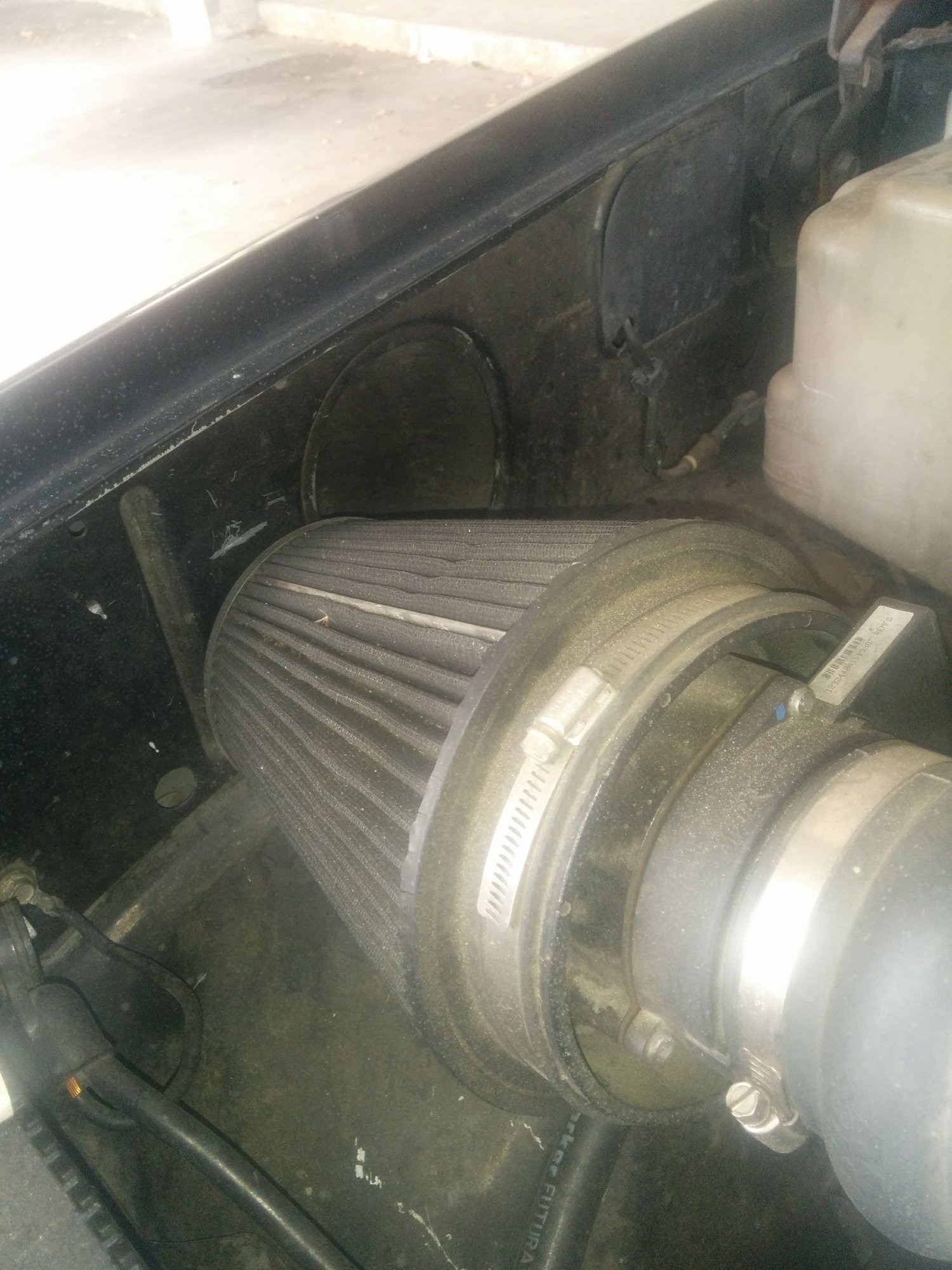

Nice pics, THANKS! I`m looking that up now. Is that maf just sitting in the cone?

I guess, yeah.
I found a guy on Craigslist with a truck full of those kinds of 'accessories' and we cobbled it all together in a 'quick' fashion so I could quit running around without an air filter. That was about 5 years ago...
My OEM Cold Air Box is hitting the A/C fittings, and maybe the A/C Compressor, which caused a full-stop in implementing my idea of inverting the OEM box. I bought the 2nd box to cut out the plastic on the front side and use that cut out piece to repair the plastic on the back side. Maybe use just the right 'elbow' to connect the front of the box to that existing pipe. That 4" pipe is way larger than I need and would probably prefer putting in a more appropriate 3".
I'm thinking I can use a K&N filter that fits that box, mount it solidly to the inside of the box, fit an elbow or whatever fits to the outside of the box angled towards the pipe and fit the MAF somewhere that's proper. I seem to be dealing with some (hopefully) false knock that affects performance at low RPM's.
At last check, I wondered if I maybe couldn't rotate the A/C Lines more inward towards the engine to allow the OEM Box to clear them, but I haven't bothered to check if that will actually work.
