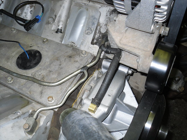

This is a 2002 Suburban engine that I converted to a four corner seam vent system...I plumbed it into the top of the water pump. This is in my 72 Greenbrier A-body wagon. Works great.
