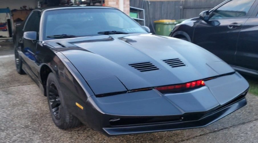

Cool car!

Thanks mate.

Sweet looking 3rd Gen bird
IMO - If the car will see much in the way of mileage as a weekend or daily as mentioned earlier in the post, higher stall locking converter would be a nice option. From experience non locking generates more heat & less gas mileage.
thanks man
I always wanted a KITT car since I was two years old, so when I got the opportunity I made it happen. Now I just want it to make it form point A to B LOL
