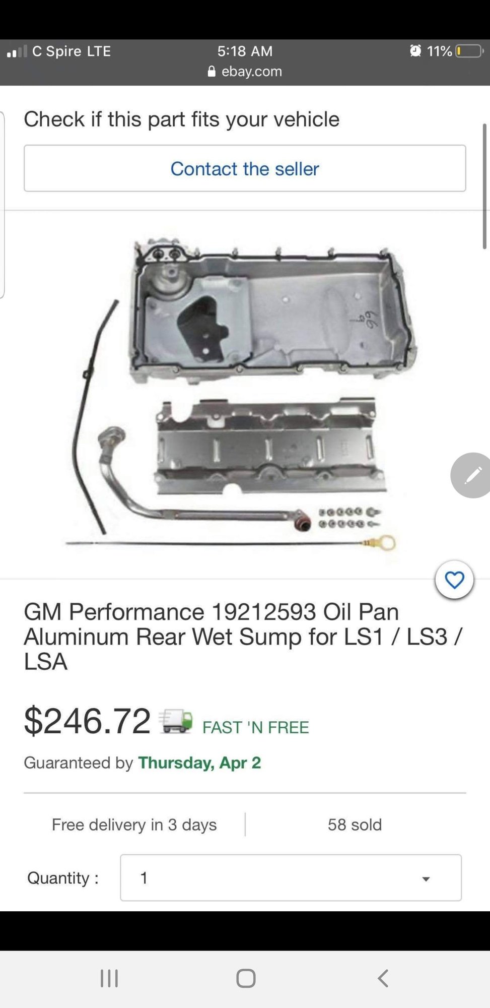

I need to know which oil pan to choose for an huron speed turbo build. Engine is a 5.3 , melling oil pump, 4l80 trans, all going in a 2001 Camaro

Most oil pumps don't meddle, but the Melling pumps do pretty well.
Your present pan should do the job, just needing to have a turbo oil return drain installed.

Thanks. Auto correct took over and spelled meddling..so just the ls1 factory pan?

I don't see why not.

Or you can put the drain in the timing cover. I chose timing cover because they are cheaper and easier to change if i ever need to.
