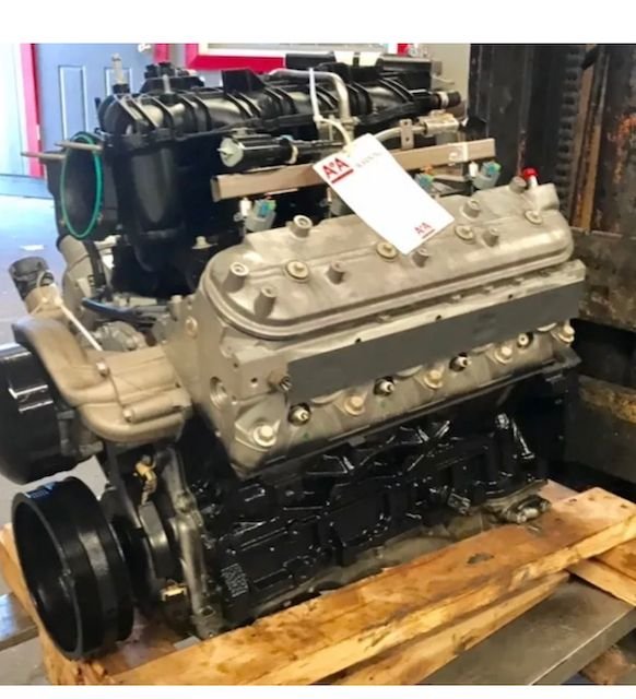

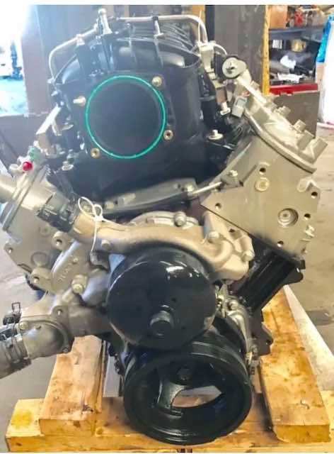

Hey everyone! I think this is my first post here, glad to be here! Here's my situation , I'm doing an ls swap ( Standard truck motor) 4.8. I ordered it on eBay, for a good deal, with only 85k miles , saw videos of it running glad I did this. What I'm trying to do is pretty much confirm that this engine is a LR4 . While I wait for the motor to arrive, was trying to build my parts list and gameplan. The shop has sent me the truck vin : 1GCEK14V21Z290024, and from the 8th digit that's and LR4. But if you look at the attached pictures, there is a sensor on the timing cover? From what I can find online a LR4 wouldn't have that sensor there. So it has me wondering if the motor was maybe replaced at some point with a newer engine? Or is this a LR4. Im trying to figure it out so I can answer these questions and if anyone knows by looking at the pictures it's greatly appreciated!
-Was it DBW or CABLE ?
-Which ECM to get / harness to get or order
- fuel rail return style or non , so I can either order regulator or high pressure pre filter.
Thanks much everyone, I have looked through sticky's and other posts , hope I won't make anyone mad with this!

Can't tell what sensor you're asking about. Post a pic of it from up closer when you can.
Looks like a 4-bolt throttle body; probably DBC. Looks kinda like it has the flex-fuel injectors.
The heads have been replaced, with ones from a "rebuilder". You can see the little overheat melty indicator thing in the driver's side one, in the freeze plug.
If it's a 4.8, the pistons will be flat-tops, and the block will say "4.8/5.3" on it. They have the same bore, just different strokes and pistons. You should be able to easily see into a cyl with the spark plug out.
What is the head casting # ? 3 digits, outer front corner of pass side head just below valve cover.
Year code in the VIN is "1". I've lost track of the years; what year is that? Came from a vehicle mfd in the US (1st digit of the VIN is country code, "1" is US, most trucks are "3" Mexico); any idea what kind of vehicle it was?

These are the only pics they had, but the front cam sensor I believe is what its called? It's on the front of the timing cover , right by the crank pulley. also wow! I had no idea, I can't tell from the pictures either, I just messaged them asking for the head numbers , so hopefully will have them in a second. they Said the engine came out of a 2001 Silverado 1500, and from online the vin is 2001 as well.

Well thanks all for the replies lol . The shop just messaged me saying don't bother looking at the photos. These are just all stock photos for them. So I'm an idiot but lesson learned , from now on maybe message them first! haha have a good one
This is likely not true, all the salvage yards in my area use these on unopened pull out engines. My last salvage engine had them and I was the first one to take the heads off of it
