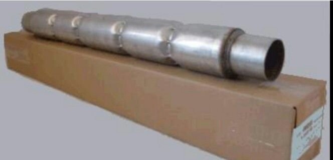

Also some guys get rid ove the "mufflers" that come with the SE dumps and put a set of powerstick chamber mufflers in place and they sound amazing. Do some YouTube searching on it, see what you think.
