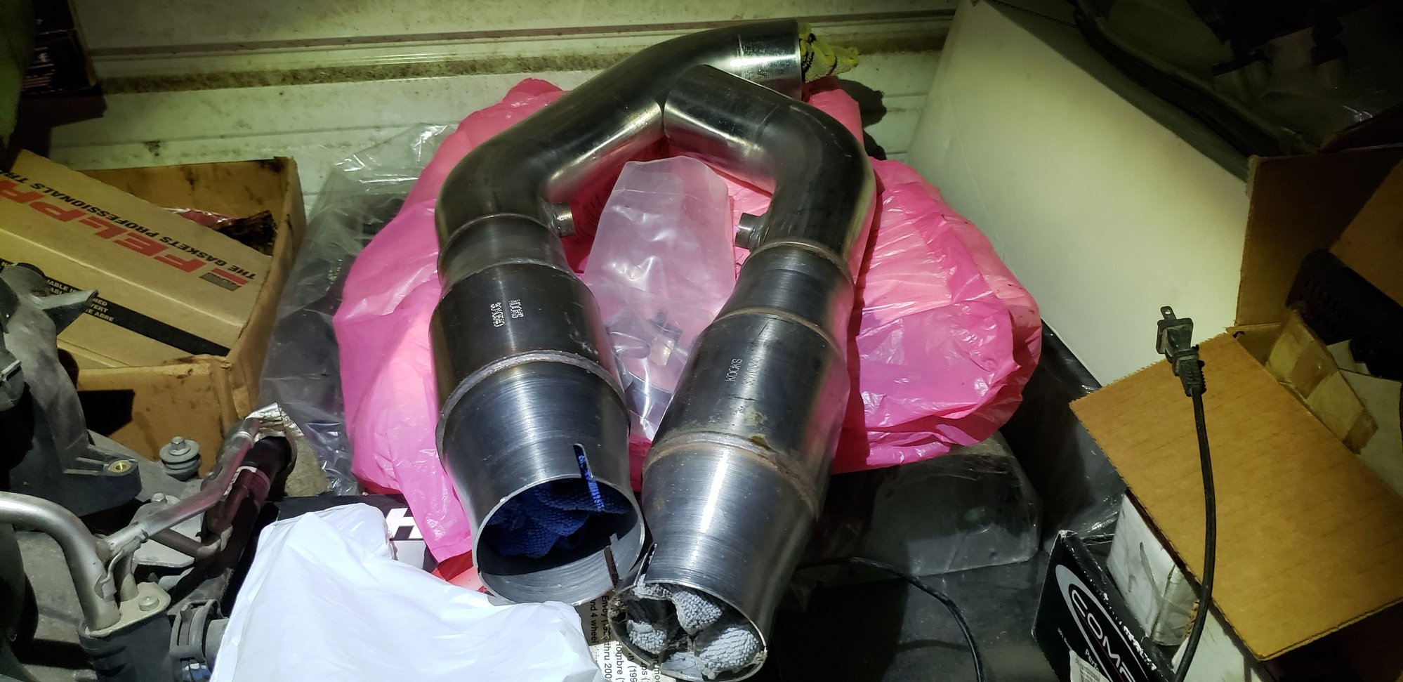

Thank you. That really explains things. I do notice in the picture that the cats have a slot cut into the ends which might make it easier to slip them over the legs of the Y pipe. You have the X pipe apparently.

Here's a picture of the cats. I purchased the KOOKS true dual off-road exhaust system and then later purchased the cats but yes it slips on and is held into place with clamps.
I have been thinking about doing the same to my Kooks TDE. In my mind it was going to be a lot harder task that it is. Thanks for the info.
