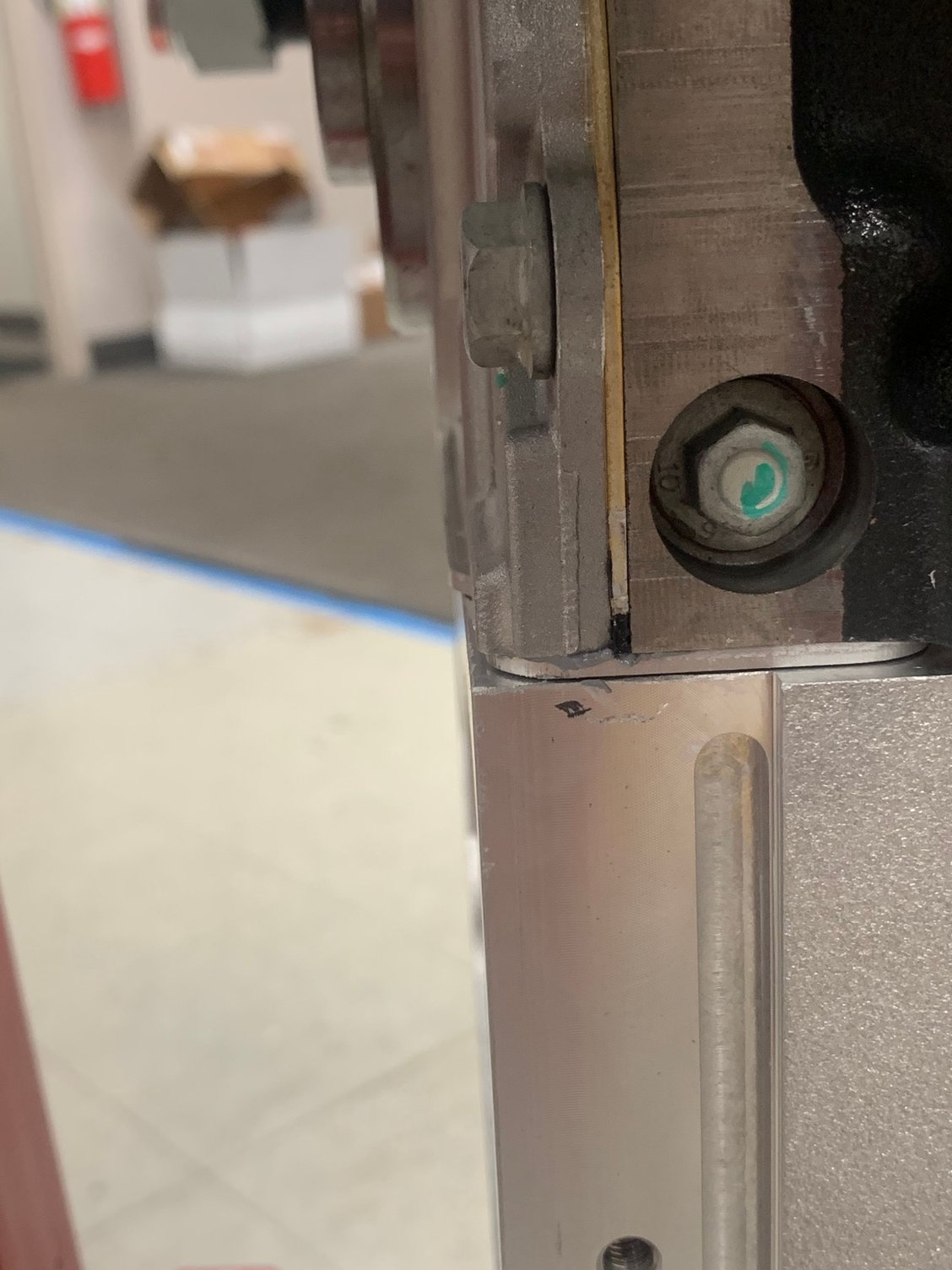

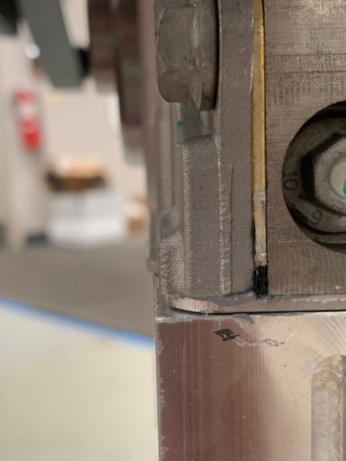

Got everything torqued on my Holley 302-2 and noticed it’s protruding in the rear a very small amount. I know the pan has to be as flush as possible with the rear cover so anyone think this is an issue? I’m running a T56 Magnum btw

You MUST run a long straight edge from the bellhousing flange down to back of pan mounting flange. The bellhousing bolts to both and the surfaces must align, or you’ll have transmission mis-alignment or even worse broken parts. I use a 24” machinists straight edge, but anything really straight such as angle iron, would do the trick.
