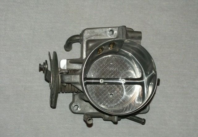

Yes, porting is worthwhile, especially with that combination.

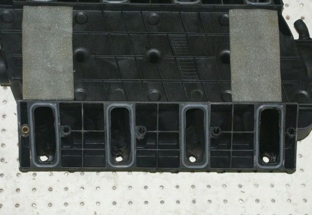

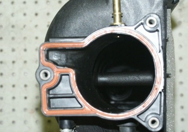

But have to be careful not to port the TB so much such that it is bigger than your intake manifold. Apparently this causes problems.
I had mine ported from Vengence Racing, years ago. If they still port get the intake done too, so it will match the TB. They do this work.
This is how I was able to pull off 344 rwhp, with just 50-state legal boltons.
Here's some pictures of the work done:
