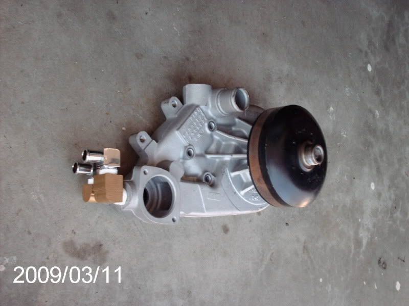

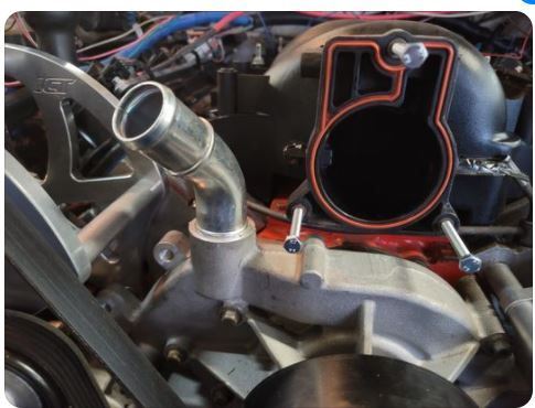

Anyone know what engine this style pump came off of? I've installed an LS1 intake on a 5.3. But now the TB won't clear the standard WP. From what I've seen this pump will clear. But I can't seem to find it. Any suggestions? I'd like to get the 3 bolt DBW TB on there as it's what I have.
It look's like an LS2 pump, but has truck spacing.

Possibly the Trailblazer SS which came with the LS2??

Show a better picture. It looks like a standard 99-07 classic Truck Water pump to me.
The top pic is definitely a truck pump. I THINK he is asking about the bottom one.
The bottom one Looks like a standard LS1 Corvette water pump that some one modified an for some reason put a truck pulley on it.

I think it's easier to just use ICT Billet water pump spacers, Then you have several pumps to choose from and they are already tapped for your steam line.
