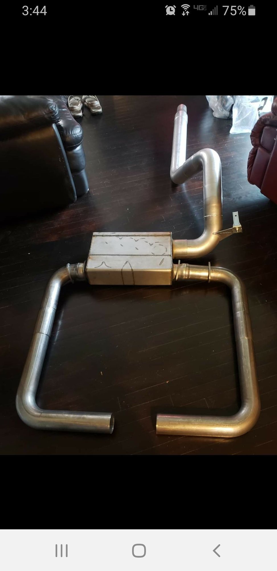

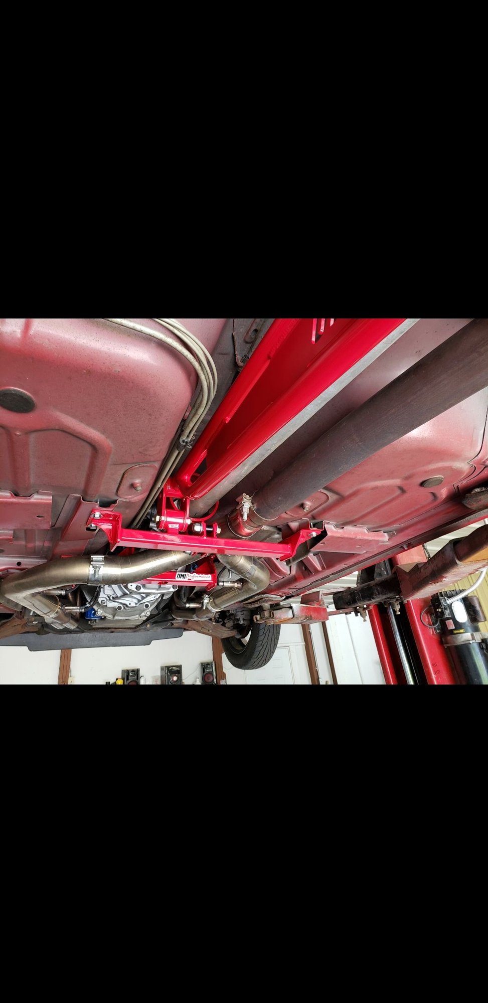

UMI... altho this is the stock exhaust, this will be my 2nd install. It clears nicely. I'm installing the Mufflex 4". Dennis made a 3" to 4" tapered pipe to adapt from the Kooks Y pipe...
It's the Y pipe that clears the crossmember... not the 4" pipe.
He made these bends to work with my CME. You'll notice the 2.75" stock inlet. That will be cut off... and install the 3" to 4" tapered pipe piece.
Tips... It clears without rattles
Hope this helps
