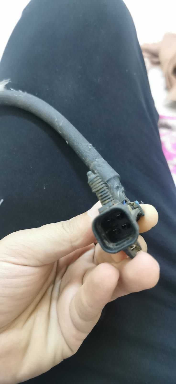

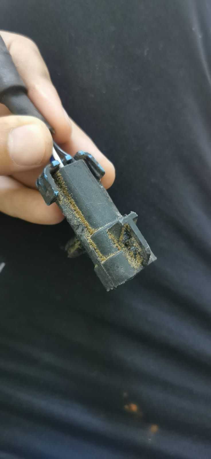

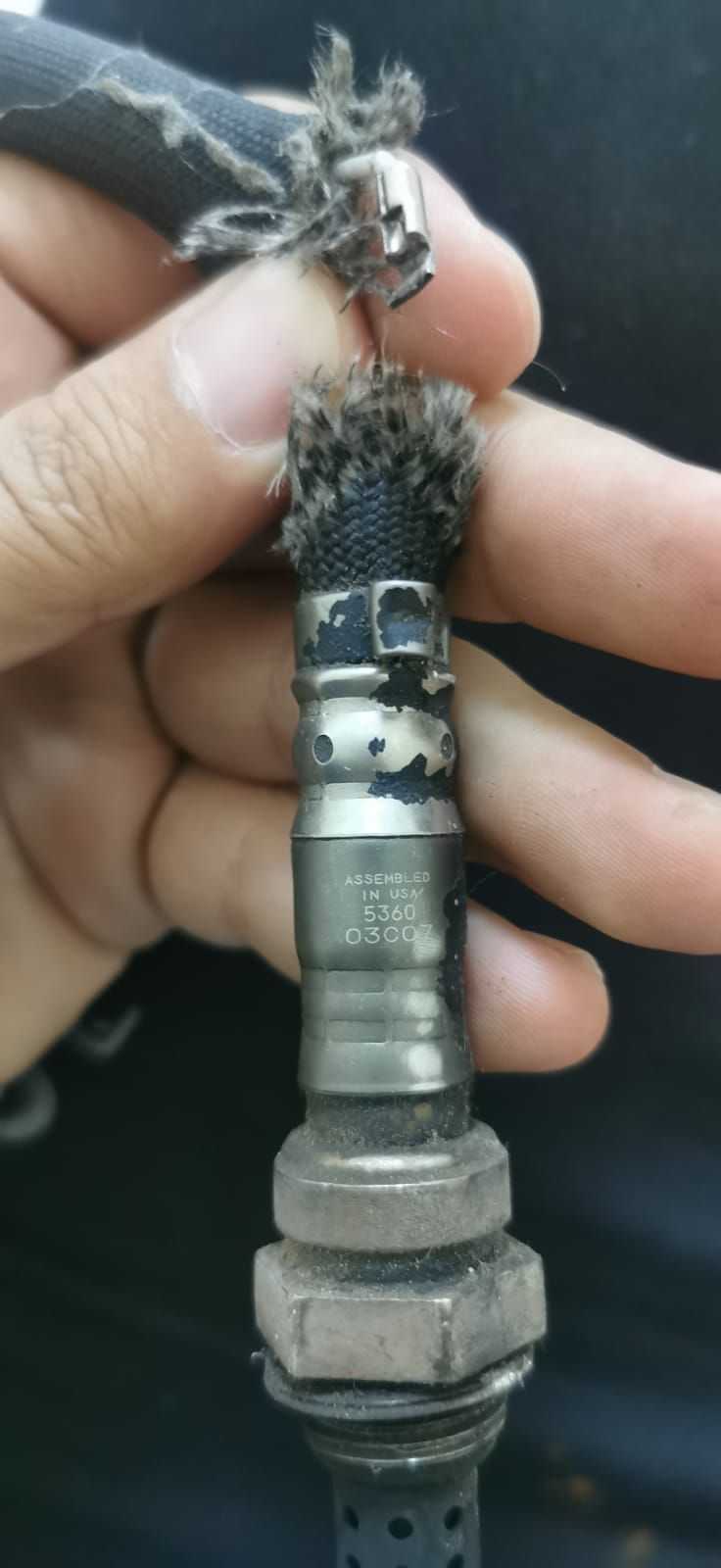

Hi all
Need some help in identifying these exhaust sensors on my car.
The engine is a lq9 with a lsa superchargered. Bought the car recently and the exhaust sensor went bad. Need the same sensor for the car.
​​​​​Quite appreciate it if anyone can provide me the part number or any identification of the sensor.
Thanks

It's a Denso, square plug, O2 sensor. Nothing special about it. What car did it come out of and was it a front or rear O2 sensor?
Old Nov 27, 2021 | 04:21 AM
LilJayV10's Avatar
iTrader: (39)
Posts: 9,711
Likes: 999
From: Evansville,IN
Depending on the year and application, I think they are grounded differently, the connectors and pinouts are different IIRC.
The connectors are physically the same, but there is a tab on the inside of the connector that matches up with the male side. The tab is in different locations on each style so you can't plug them in to the wrong sensor.
