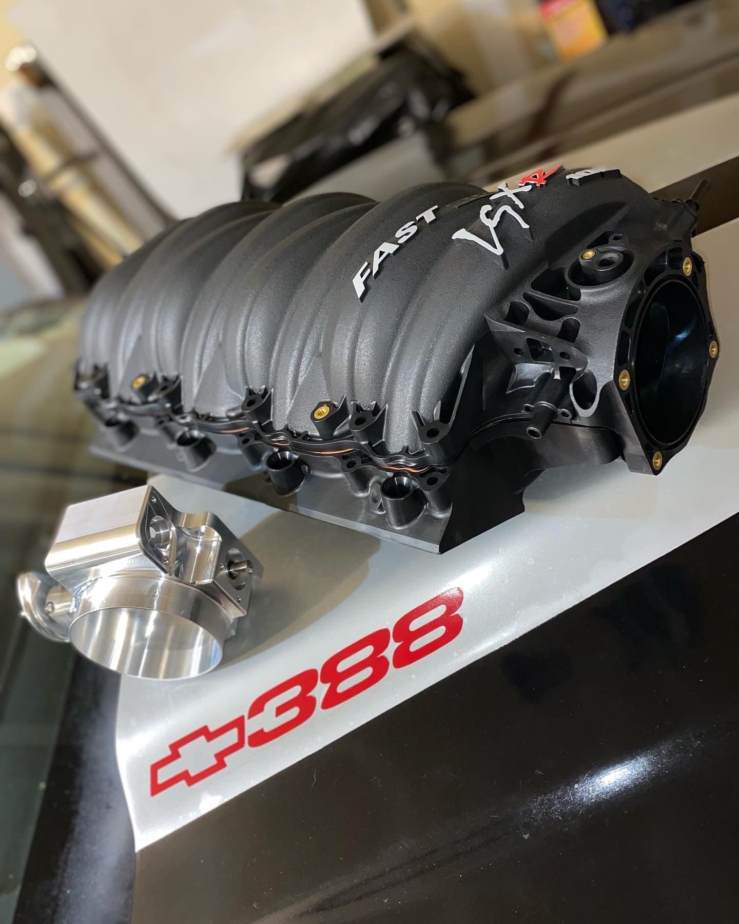

I’ll jump in on this because I’m in a similar boat. I just got the FAST 102 intake and a Nick Williams 102 Throttle Body.
I love them so far! I do have one question though. I bought the upper and lower halves of the manifold because it was about $200 + cheaper than buying the whole manifold. But what bolts hold it together? It didn’t come with any. And are they bolts AND nuts or just a screw bolt? Also, no hardware came with the TB. What size bolts hold the TB to the intake? Thanks in advance and sorry for hacking the thread a little bit. I did a search and this was the best thread that came up.
