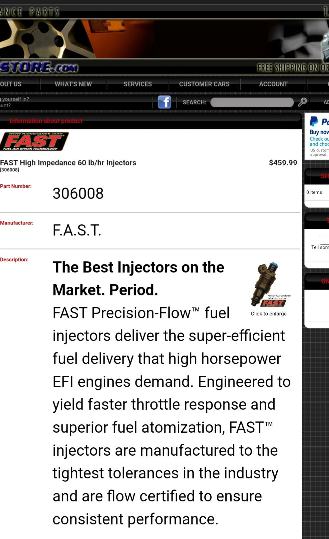

The LSXR 102 uses ls2/3/7 style injectors.
I'd probably spend the extra $20 for the Fast 60# injectors. The GM LSA #56 injectors might also be worth checking out.

Thanks for the replies! And good to know.. I'll probably go with those fast injectors. Is there a special harness or anything else I need to buy with the ls2 injectors to make them work?

Don't use FAST injectors....ever.....
FWIW,
I used the Racetronix fuel rails(very nice BTW), FAST 102 and ID 1000's(stock LS1 length)and had to make my own hold down brackets.
The brackets that came with the Racetronix rails worked fine on the stock intake but wouldn't work on the FAST 102.
