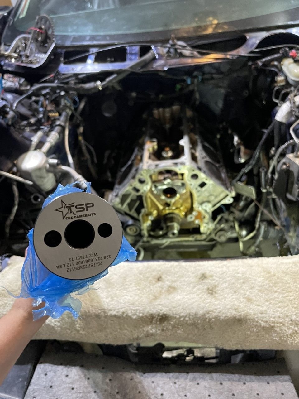

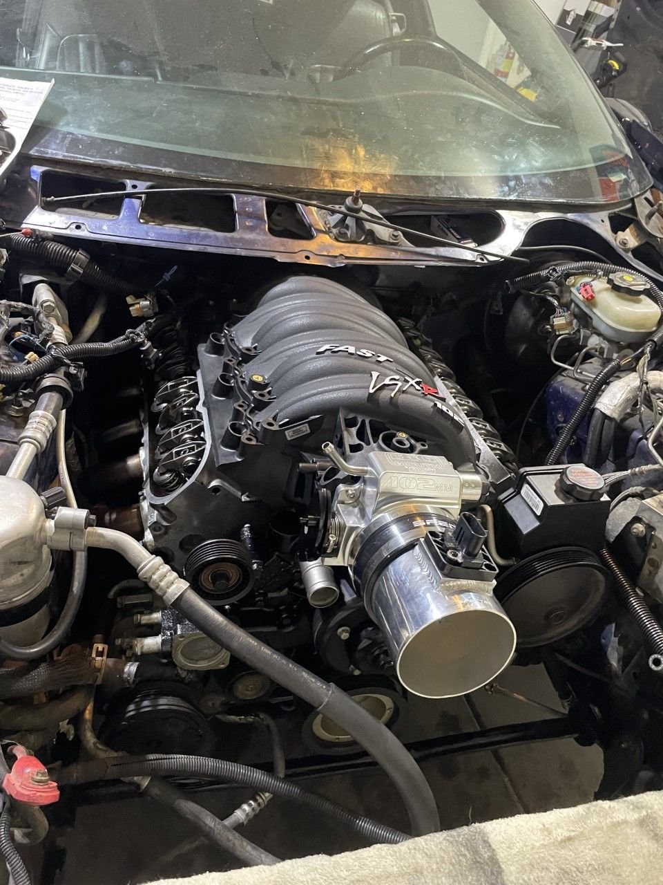

Hello, I will be done with my LS1 camaro build here this weekend and Im just kind of wondering what the procedure is directly after the build is done. Like should I take it straight to the tuner or drive it for alittle bit and than do that.
Here's all the things I did to it to give you some insight.
Fast 102 LSXR intake manifold and big gulp throttle body
TSP 228R .228/.228 .600/.600 112LSA cam
243 Heads, with TSP dual valve springs and new Michigan Motorsports 1.7 Rocker arms with trunnion upgrade.
LS7 Lifters
LS7 MAF with LS7 to LS1 MAF connector conversion
Stock injectors with Fast billet fuel rails and Fast F-Body fuel kit
1 7-8 Long tubes with ORY
Any reccomendations are welcomed including a good tuning shop near me, North west Indiana, this is my first time building a car like this so im kind of a noob on what to do when its done.

Isn't the MAF supposed to be like 10" from the throttle body?
The Fbody 93-02 era its maybe 6" from tb

OOF, well i didnt know that, but its not too late to change it so i will
