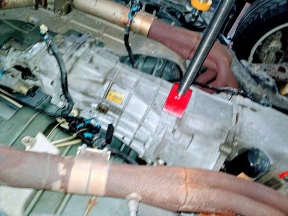

Upgraded to Magnum & LT headers & Y pipe stayed in place.
Long tubes headers & stock T56
Headers & Y pipe stayed in place

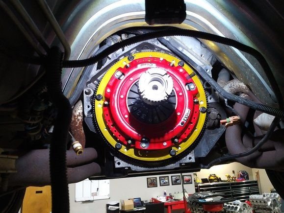

Old stock clutch
Rear of LS1
New McCloud RXT clutch
New Magnum
