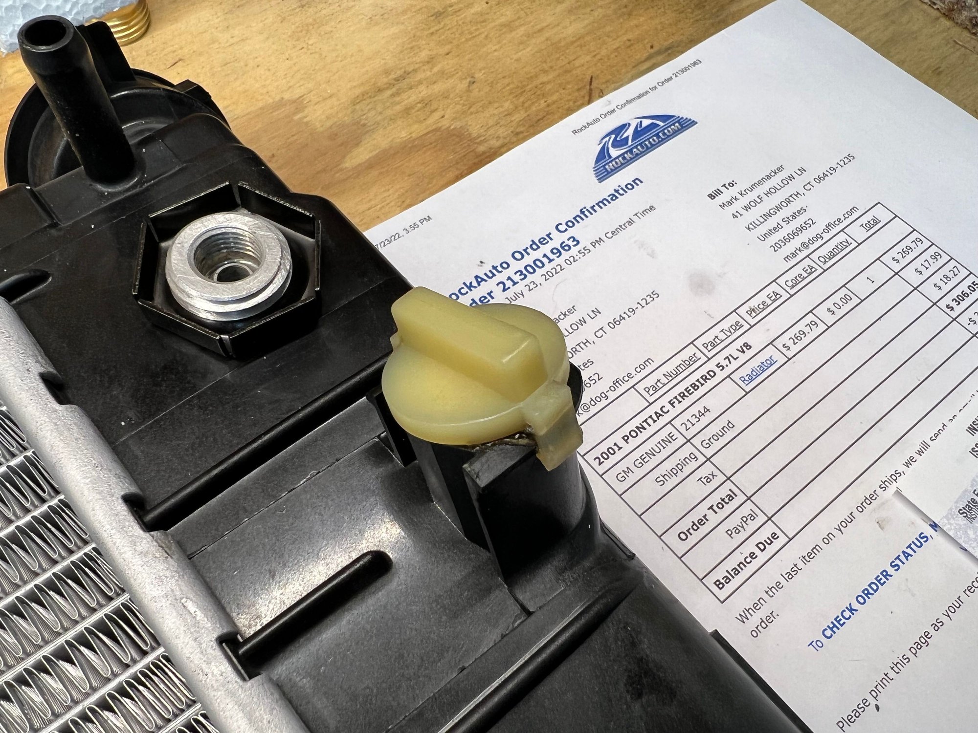

I've done some searching online and it sounds like the new radiators come with the trans lines regardless. You simply don't use them. That makes sense, but would love if someone here could confirm.
One other "fitting" that isn't on my original radiator... see attached image. Any idea what this tan-ish colored cap is for?

for a low coolant sensor... the lt1's had those

ok... that makes sense. I have an LS1 so the low coolant sensor is obviously somewhere else. So just leave this as is and I'm good?

LS1s had the low coolant sensor, too. At least the early ones (my '98 has it, and so did my '99 and pretty sure my 2000 did as well). With that said, I knew GM had discontinued the low coolant sensor by 2002 (my '02 Z28 didn't come stock with it), but I wasn't sure about '01. So I guess '01 didn't have it either.

Well i guess the cap just stays as is, since my 01 doesn't have a low coolant sensor. Fingers crossed it doesn't leak

I had a LT1 rad....plugged the LCS hole...or so I thought....came out while I was driving ....switched to a NON LSC rad ASAP
