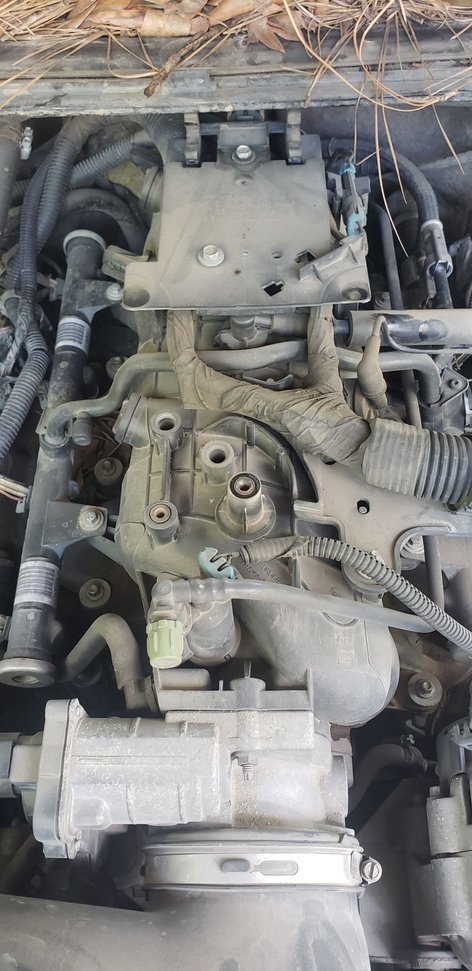

Working with an 03 Suburban
5.3L Return fuel, DBW electronic throttle.
Did these engines come with a legit PCV VALVE, or are these the ones with fixed orifice drivers side to manifold vacuum ?
What's best way to add a filter to Pass side cover ?
Can I insert a 2 port 'closed' catch can in middle of driver's side vac line ?

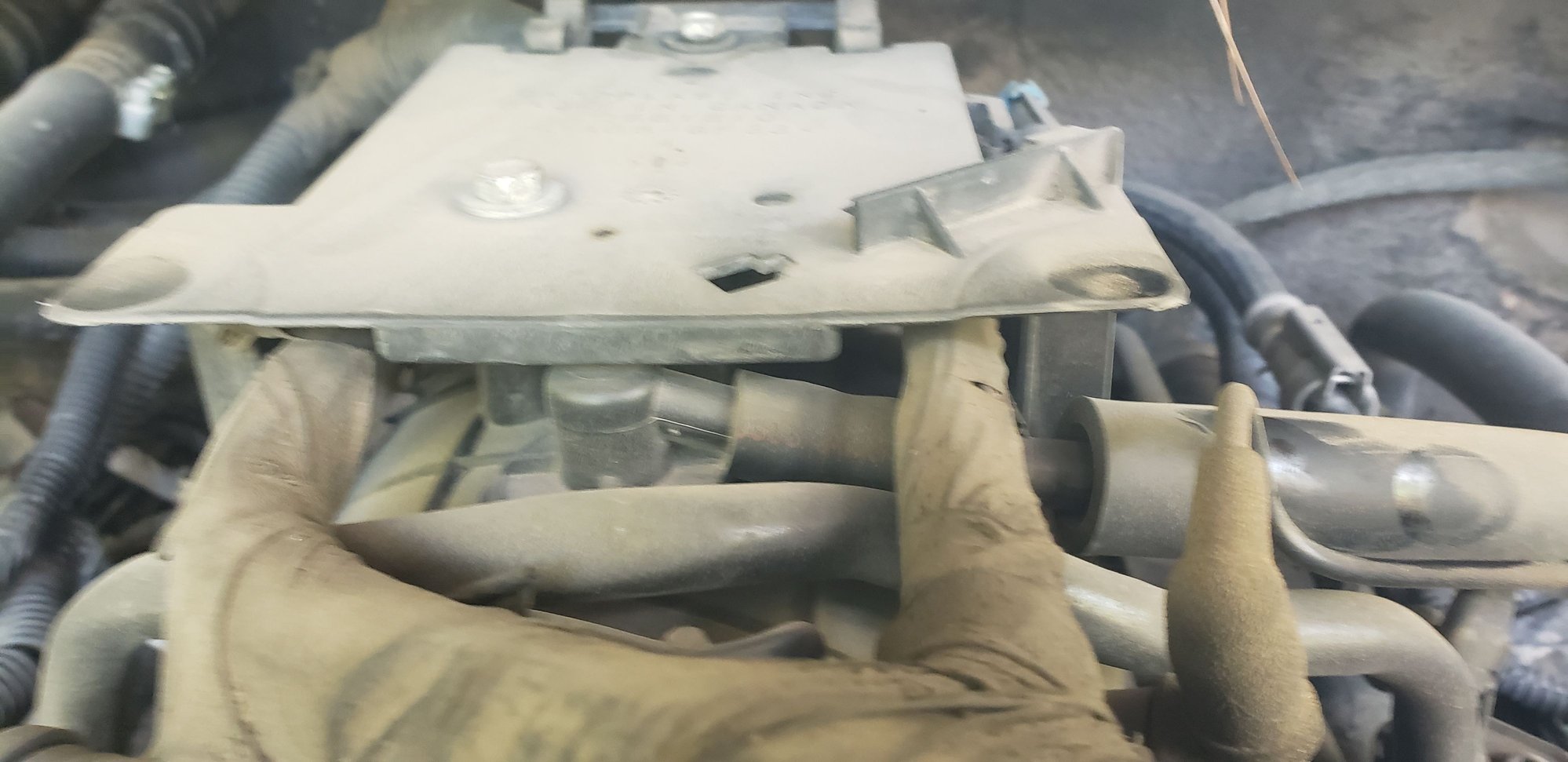

Are haveing trouble with crankcase ventilation on the stock engine?
Vacuum hose from passenger valve cover to throttle body. No reason to change this if it's a stock engine but you could cap the TB and valve cover off and install a breather on the oil fill cap.
I want to say the intake manifold has a built in PCV valve as I see nothing on the line to indicate otherwise. I suppose there could be a PCV valve on the driver side valve cover, I've just never pulled mine off to see. You could run a sealed catch can between the driver valve cover and the intake manifold or cap the intake port off and run another breather on the driver side valve cover also.
