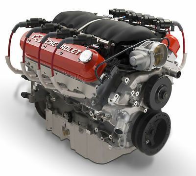

If you have LS3 coils & and LS3 coil pack harness, something like this might be possible. Unfortunately, the wires go over the valve covers.Ebay LS3 coil relocation coil kit

Good suggestion on the Proform setup, but you need the Proform covers with the attachment points to mount their bracket to.
