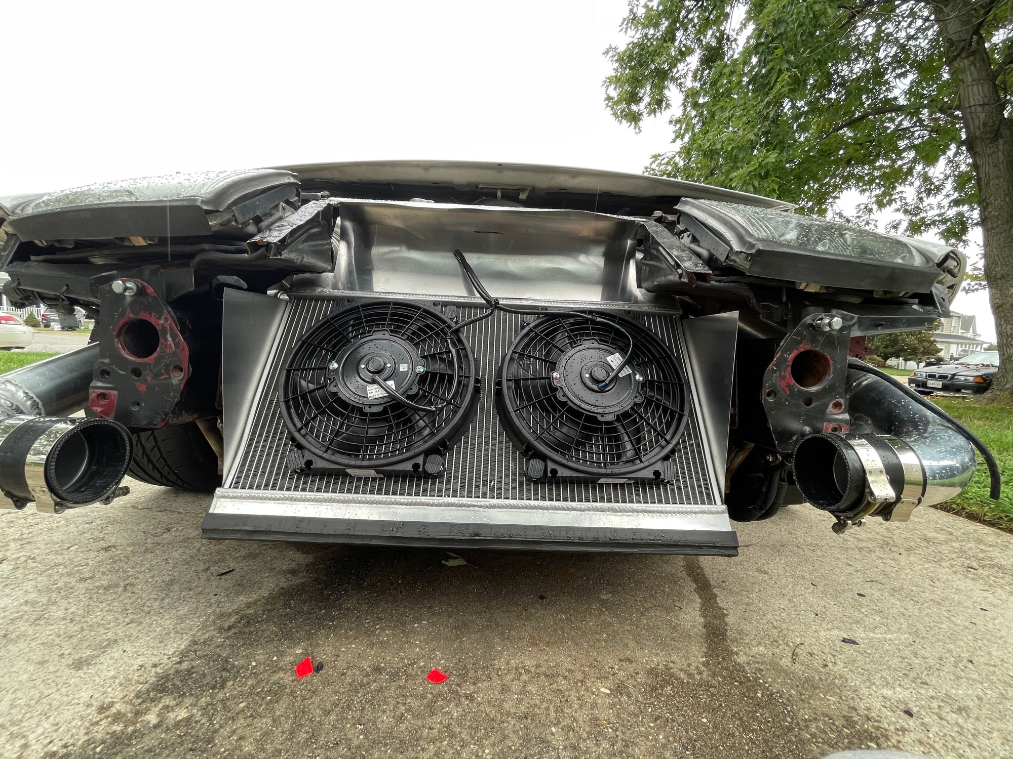

I’ve been having issues keeping my turbo 4.8 cool. I have a 25.5”x12.5” (core size) aluminum radiator in the car, and two new Hayden 12” fans mounted flush to it in push configuration. It’s at an angle, and sits behind the intercooler. The intercooler is large, but I have an air dam setup to pull air into the middle of the intercooler and radiator when at speed.
I can see coolant flowing with the rad cap off. The fans move a lot of air. I’ve run these fans on other projects and have had great experiences with them. The car has always, painstakingly, slowly crept up in temp. Idling or driving, hasn’t ever mattered. I built a fresh air system for the radiator and it didn’t change a thing. Not even marginally- so I got to thinking, and pulled the thermostat. I remember looking at it and thinking that it was oddly long and had an extra plate near the end, gave it a little squeeze, and it collapsed a bit with a pretty good snap. I figured that while I was there I’d try running the car with no thermostat to see if it made a difference, and nothing. Not a bit, same exact thing. Slow rise in temp, about the same rate.
