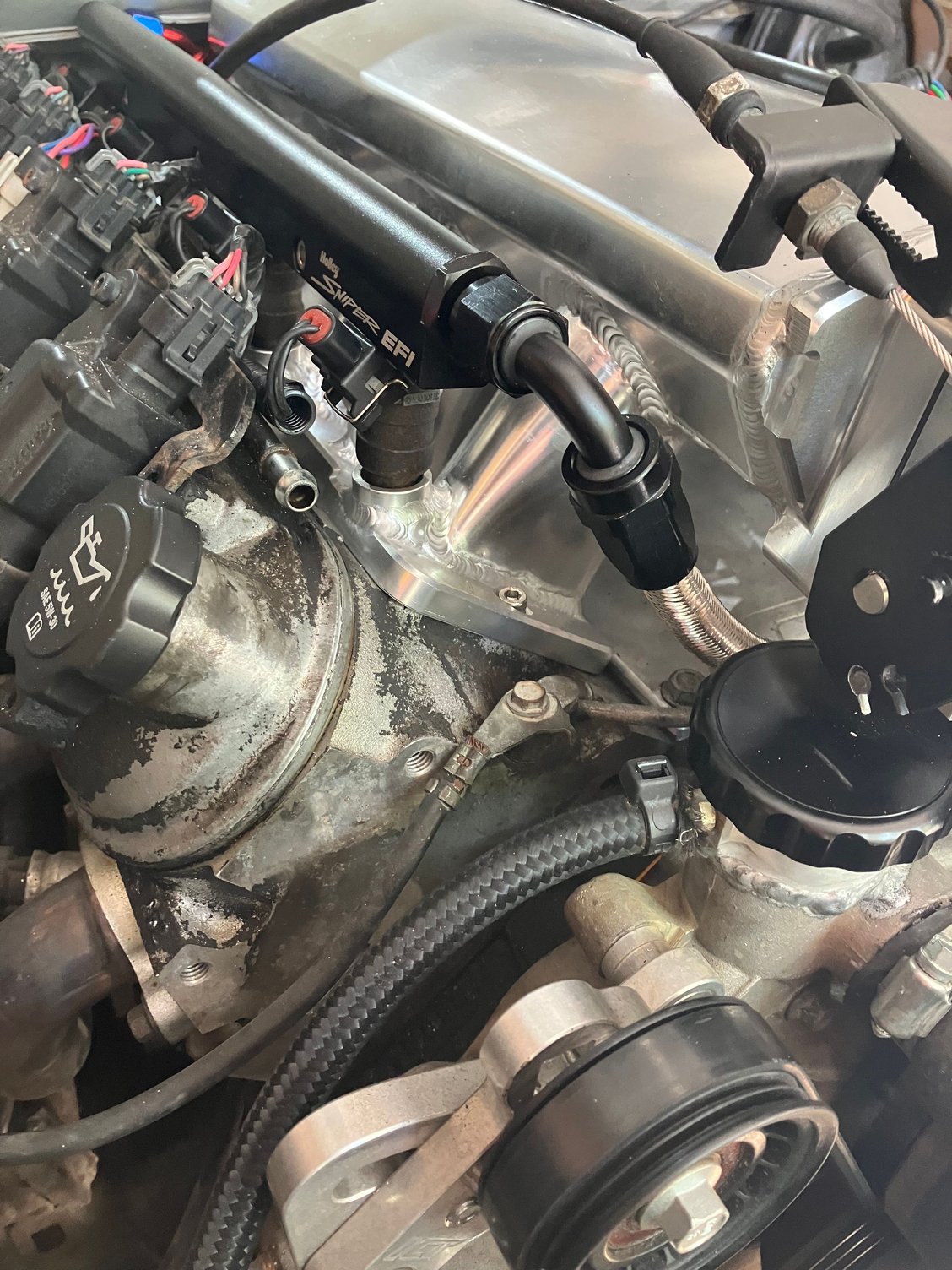

I have a 4.8L with nipples on the valve covers 1. driver rear
2. passenger front
please note I do not have a nipple on throttle body (passenger side was taken out and plugged w RTV by previous owner)
With this issue, is it correct to run a hose from #1, install in line PCV to the “in” side of catch can, than from “out” side of catch can to #2?

. On mine, I rigged the catch can between drivers side (rear) valve cover mounted PCV and manifold vacuum.
Drivers side valve cover gets fresh ( filtered air )
