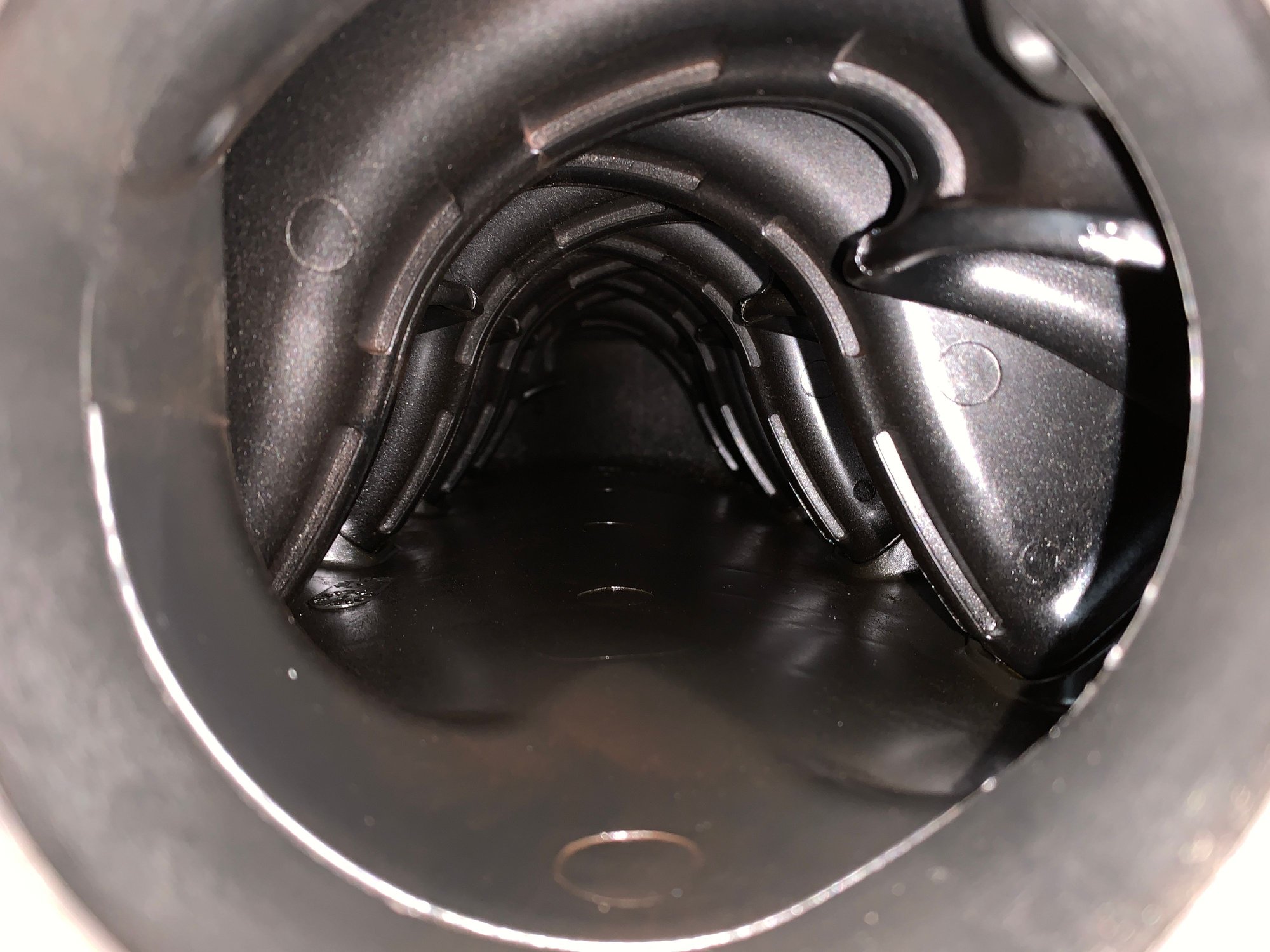

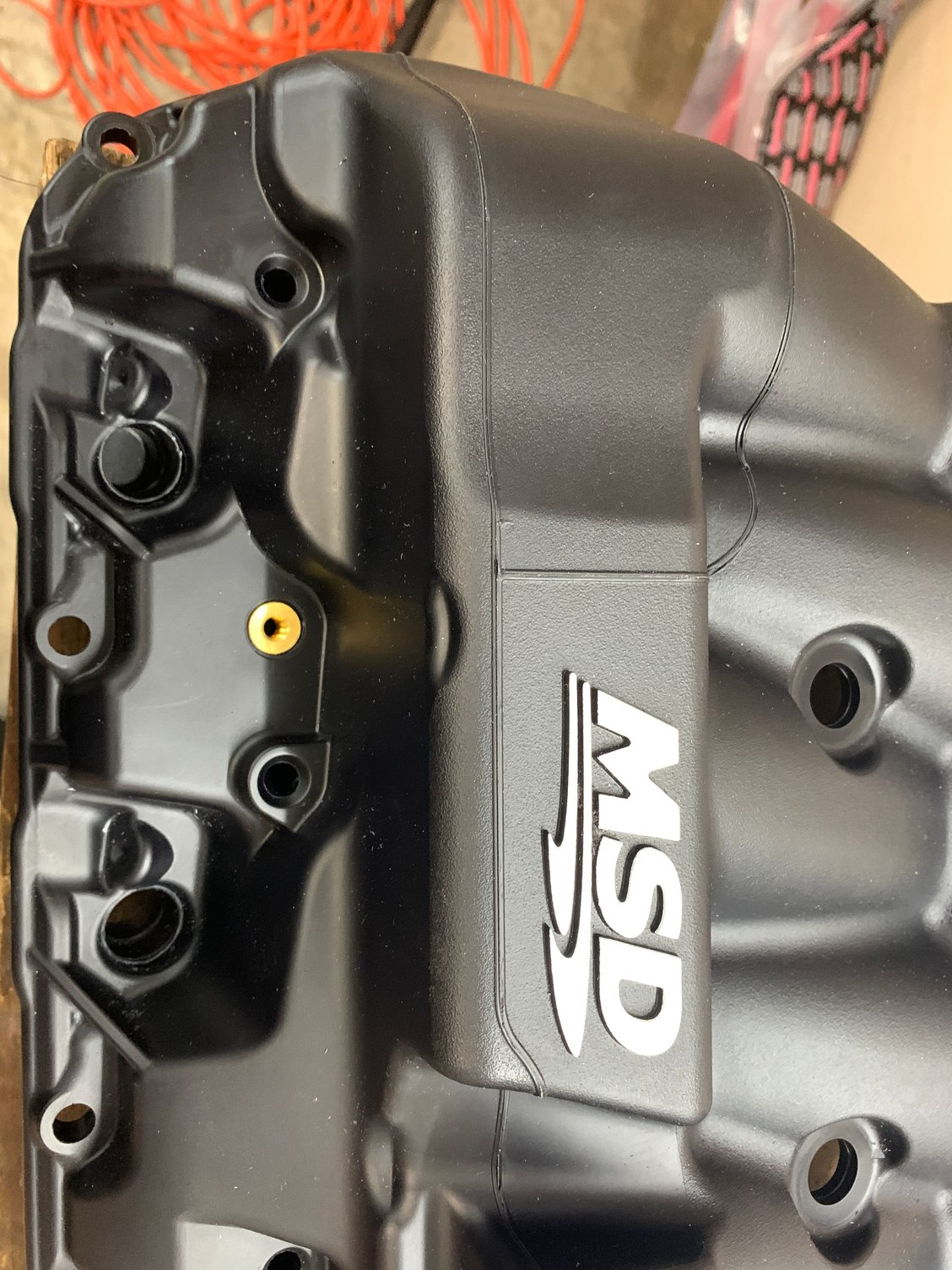

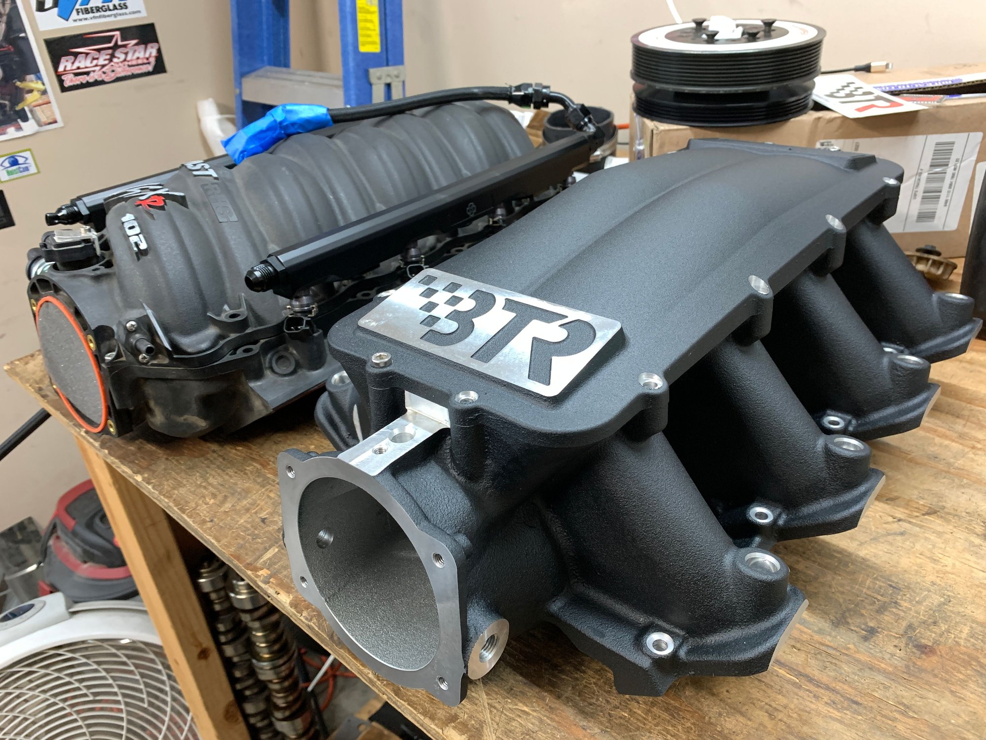

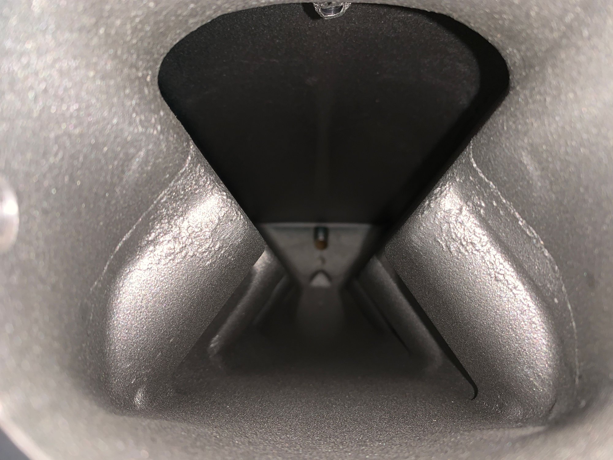

For those interested in a visual of these intake manifolds.
Cath FAST 102 VS BTR Equalizer 1
BTR Equalizer 1
Cath FAST 102
MSD
Multiple injector ports not cut.
