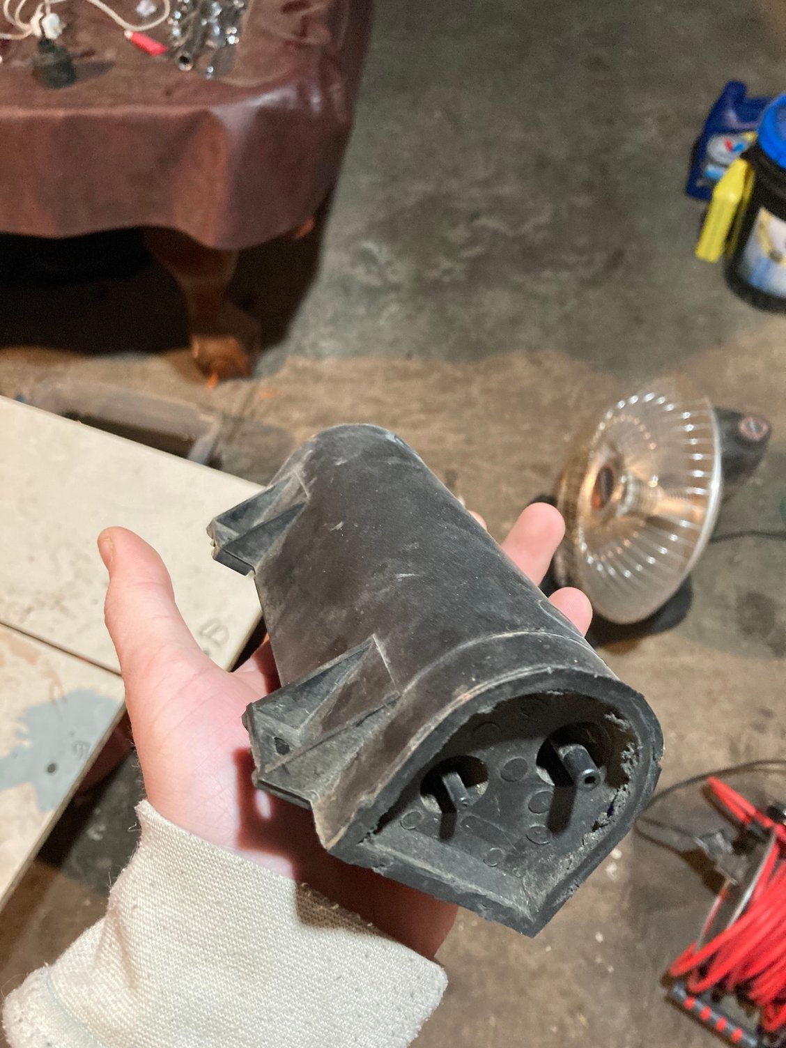

uh me again.. I also realized I forgot a part lol anyone know what tf this is and where it goes. My car is a 98 z28 6 speed. 93k miles rebuilt shortblock all stock expect slp exhaust… idk if any of that helps lol
