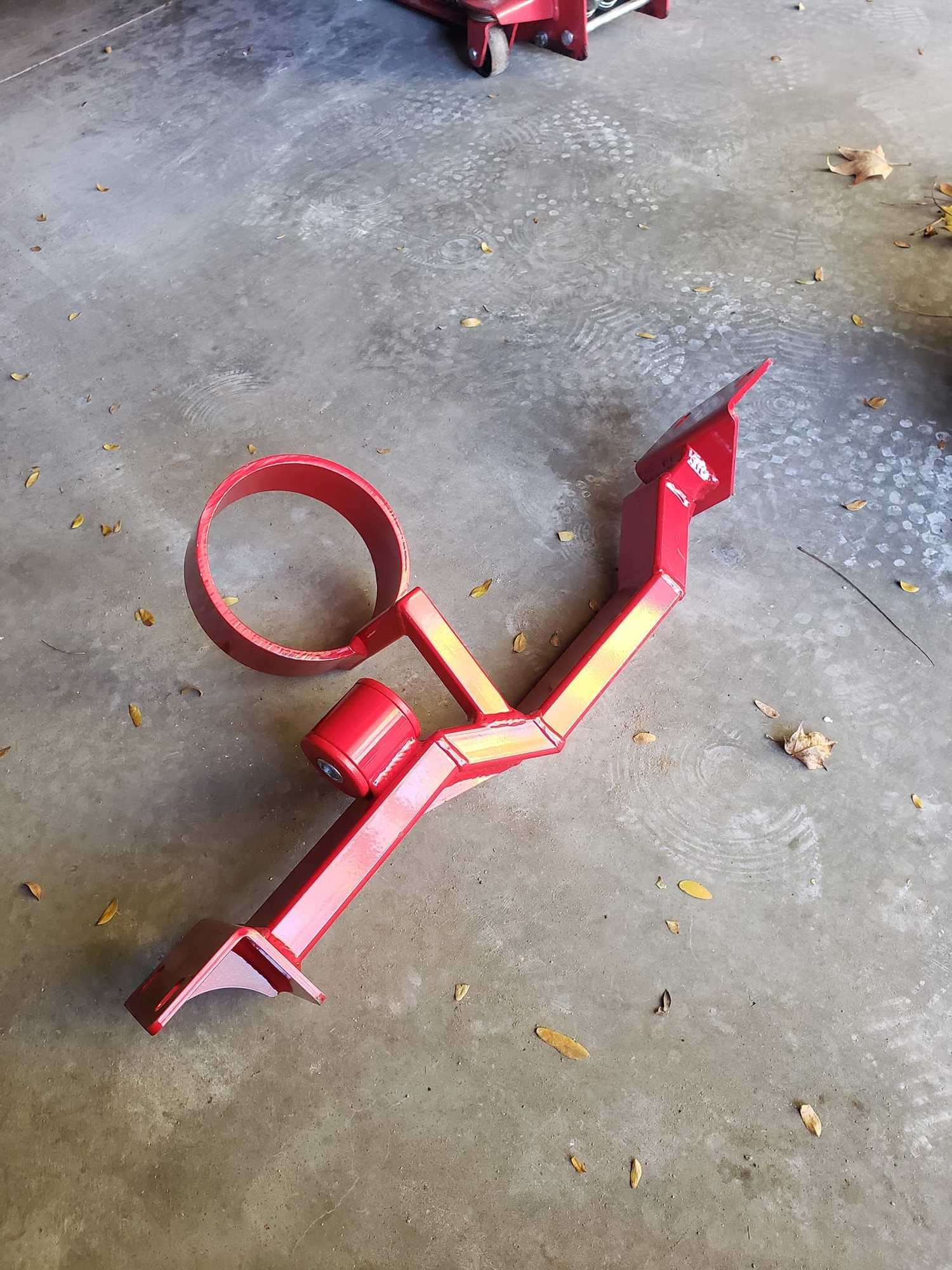

What exhaust are people running with a tunnel mounted torque arm from UMI? I really want to run true dual exhaust and want the speed engineering kit but am worried most options wont fit. Picture is the mount

So I was worried about the same thing. I didnt get anything installed yet but what i found looks promising...
I just ordered a BMR tunnel mounted torque arm kit from summit. Theres a few different styles offered but PN# TA012R says its for better clearances for aftermarket exhaust systems and has the drive shaft loop. My old BMR torque arm setup definitely wont work.
It may be awhile but ill post pics of how it all turns out.
