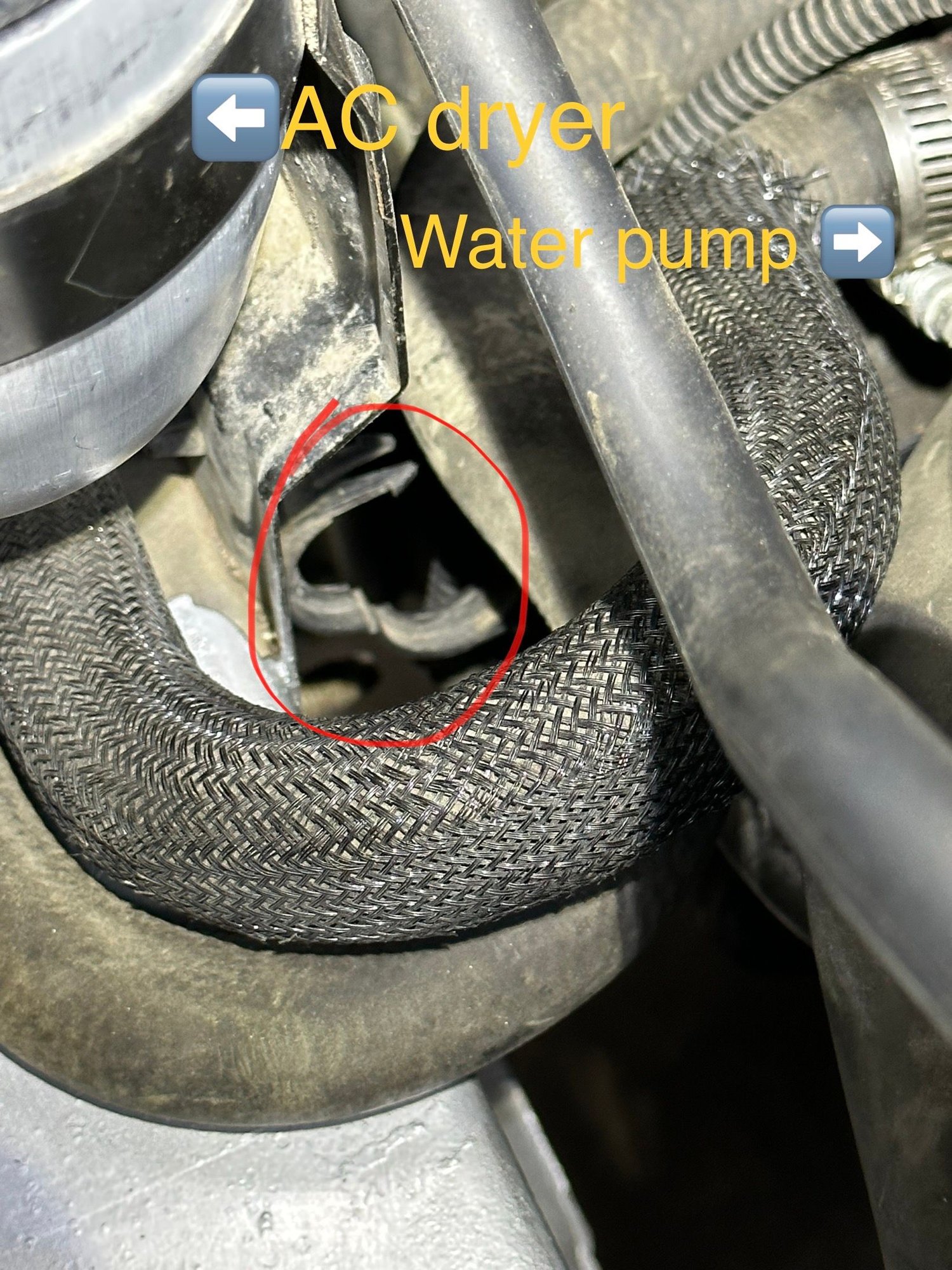

2002 LS1 car, passenger side of the engine bay, on the bracket that holds the AC dryer. There’s a round plastic clip that goes around some hose or, more likely by the looks of it, wire loom.
What goes through this clip? If you know, or if you have a stock-ish LS1 car and can check, I’d greatly appreciate it!

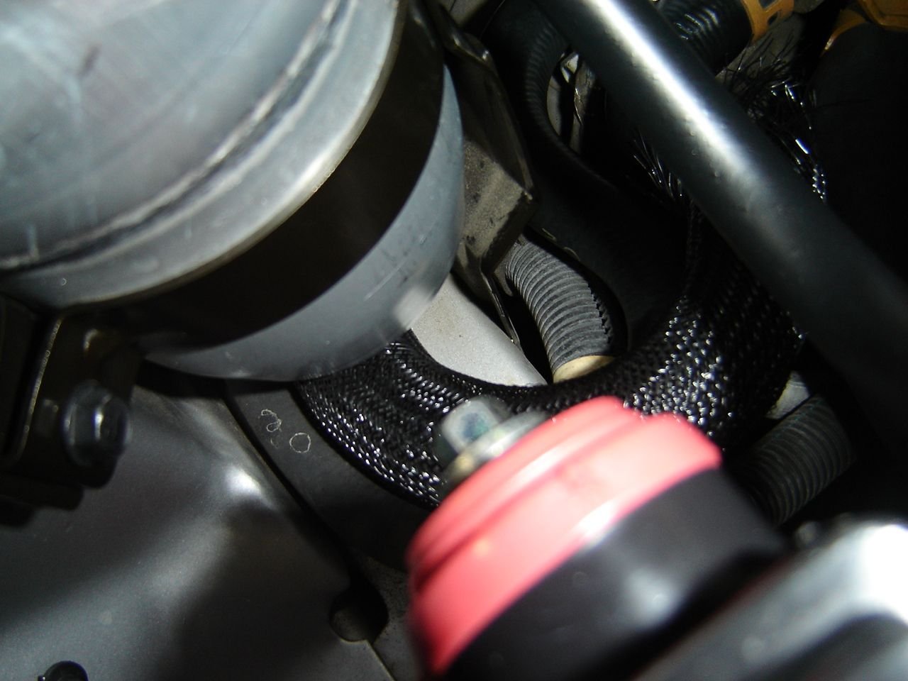

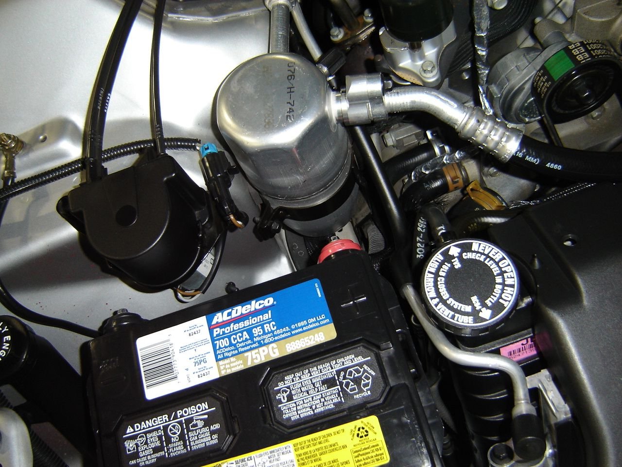

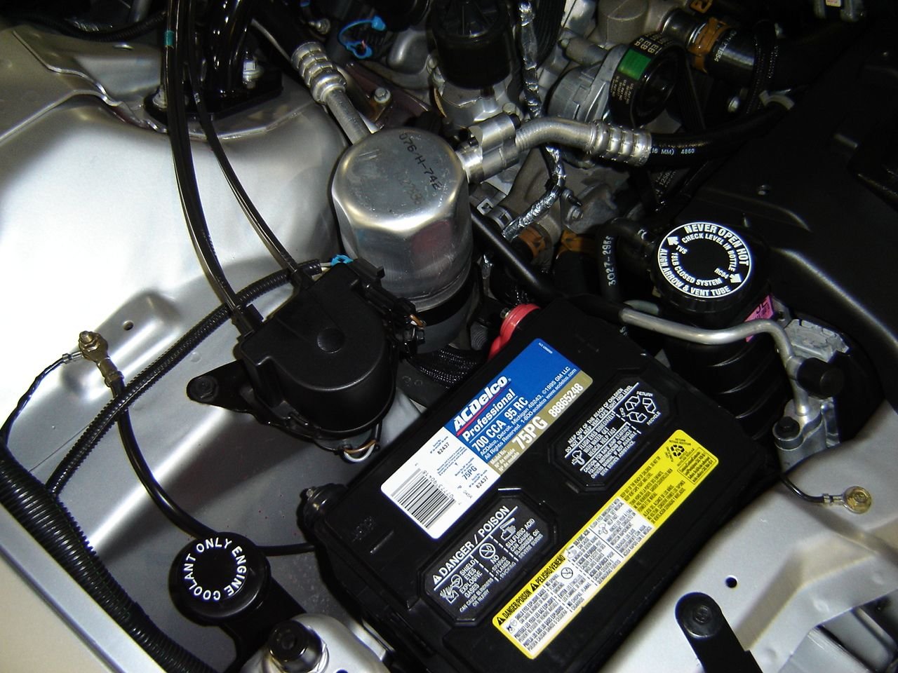

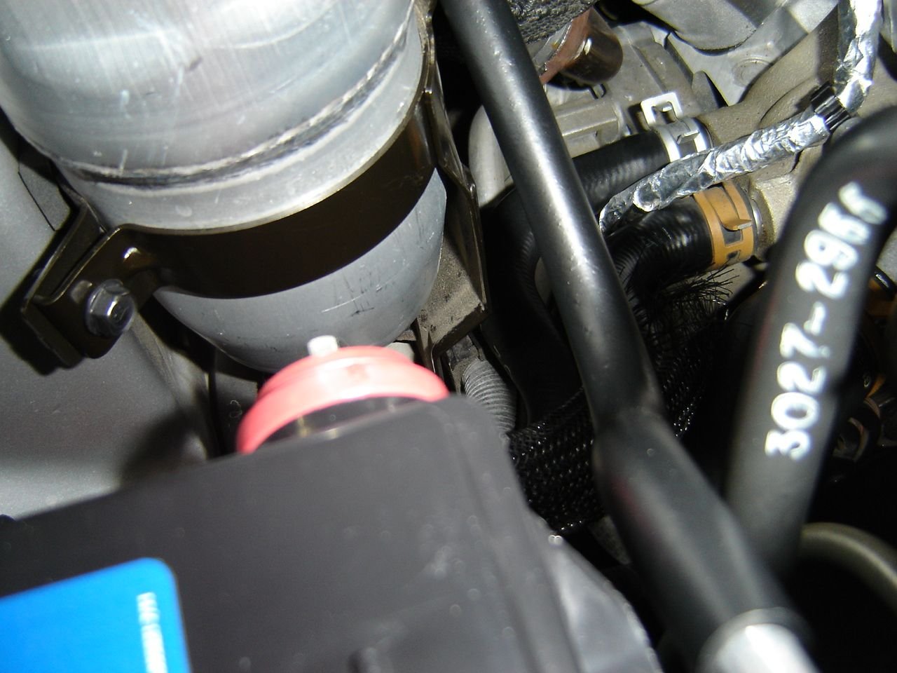

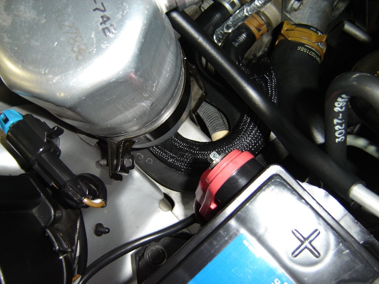

Originally Posted by JakeRobb
It does, thanks! That makes sense, because I haven't reinstalled the battery cables yet.
A picture would be appreciated, if you could.
Ask and you shall receive...hopefully this series of pictures will give you what you need to see. I had a hard time getting a really good angle and I don't see any way to get a perfect closeup of that loom routing without taking things apart, but this was my best shot:

Great, thanks much! For anyone else’s future reference if needed, that line runs back to the starter.
