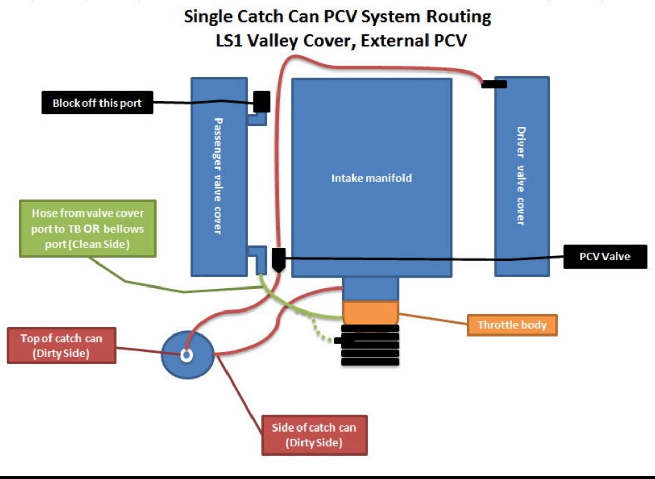

I have a LS 408 stroker I just built for racing/cruising. I am currently at a stand still because of the pcv routing situation, anybody on here have any knowledge of the routing situation? I have a fast 102 intake and a ls1 valley covers.

https://speedtechperformance.com/wp-...entilation.pdf
