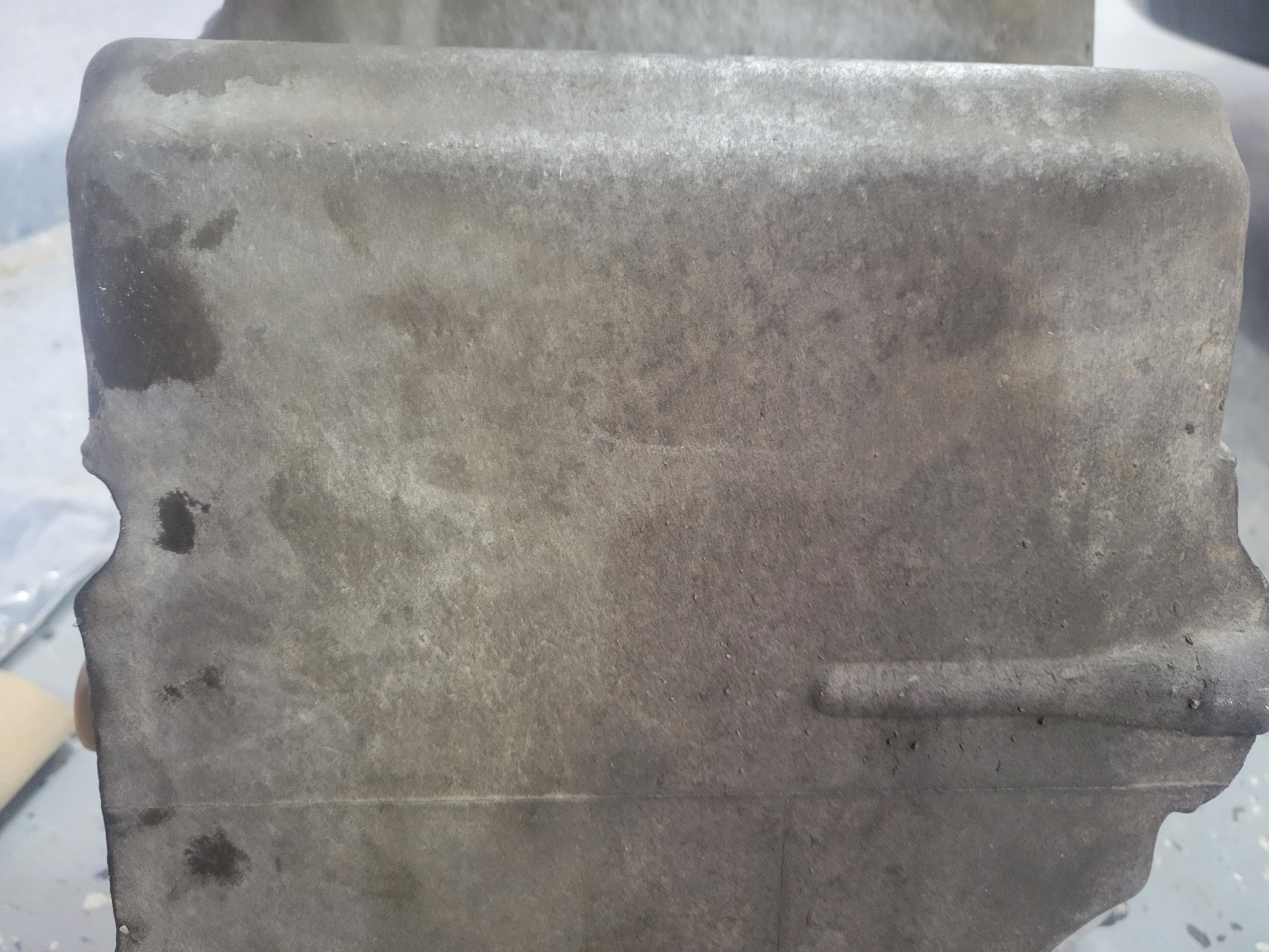

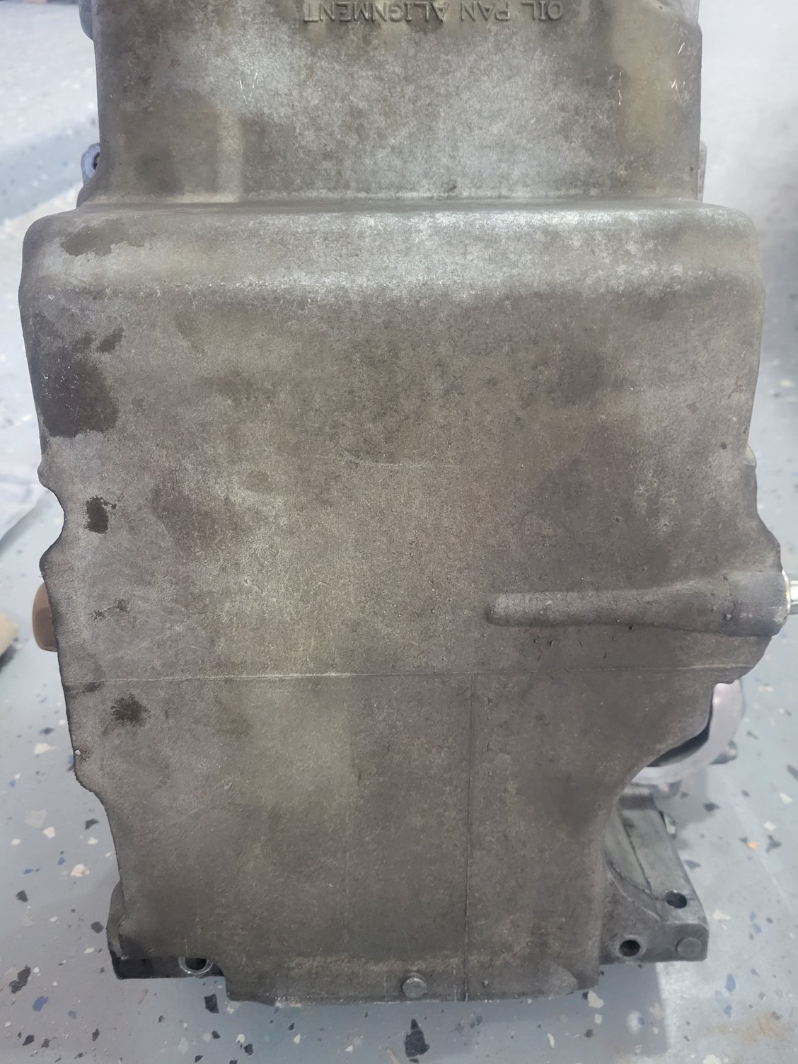

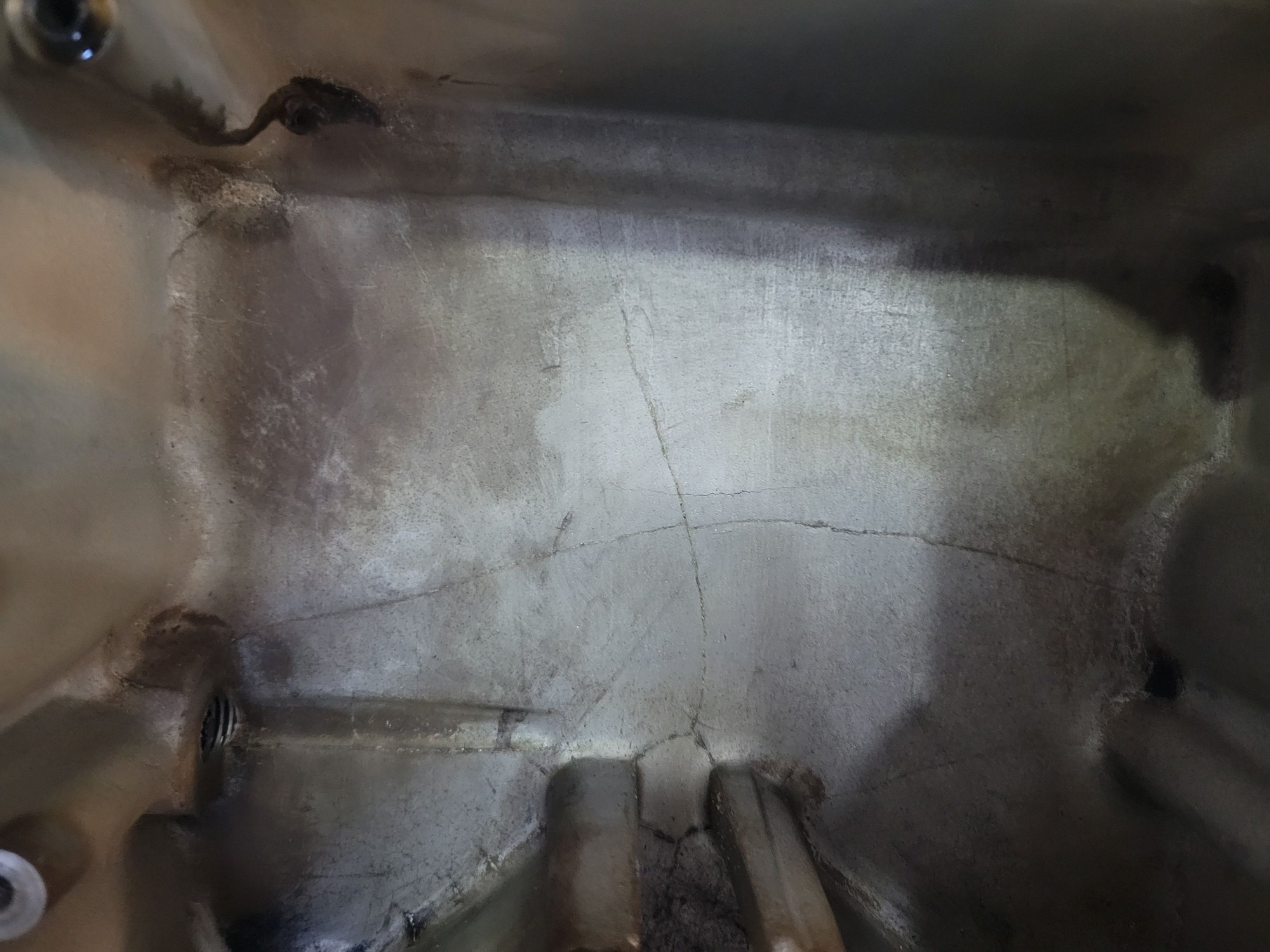

I'm hoping someone can give me some good news here. I am replacing the oil pan gasket in my 2000 Camaro SS and saw a hairline crack on the inside, bottom, lower part of the pan. I do not see these cracks on the outside of the pan. Has anyone run into this issue? Do I need a new pan?

That's not a crack. It's the normal behavior of cast metal as it cools. Nothing to be concerned about.

That's a relief. Thank you for answering. Saturday's project will continue as scheduled. Love this site

if it aint leaking...its a casting flaw......very common in alum castings
