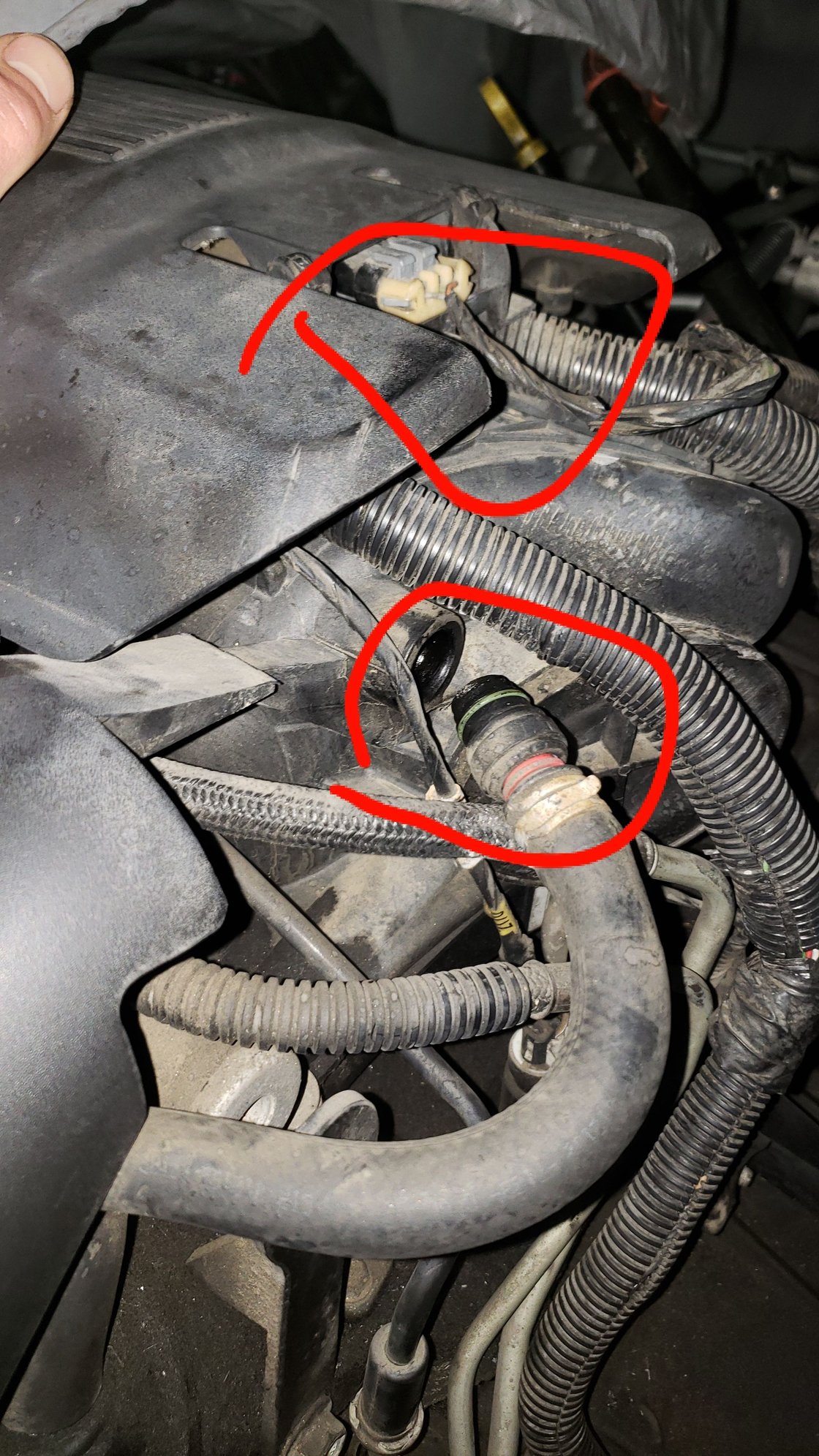

The brake booster hose fitting broke when I removed the frame off my 02 yukon. I see that some people remove the hose, but the plastic part that stays with the intake broke too so I'm wondering if anyone knows the part number for it. The MAP sensor connector broke too, but I think I found it's replacement. The engine is the 6.0 L. LQ4 I think. Thanks

Is that not an o-ring setup and just needs to be popped back into place?

It is, but if you look at the plastic on the intake manifold side of the o ring, that is what broke.
So it didn't just pop out, the plastic broke and left a fragment in there that I fished out.

Don't understand the purpose for the o-ring but what you could do is clean everything really good and use plastic JB Weld for the repair.
