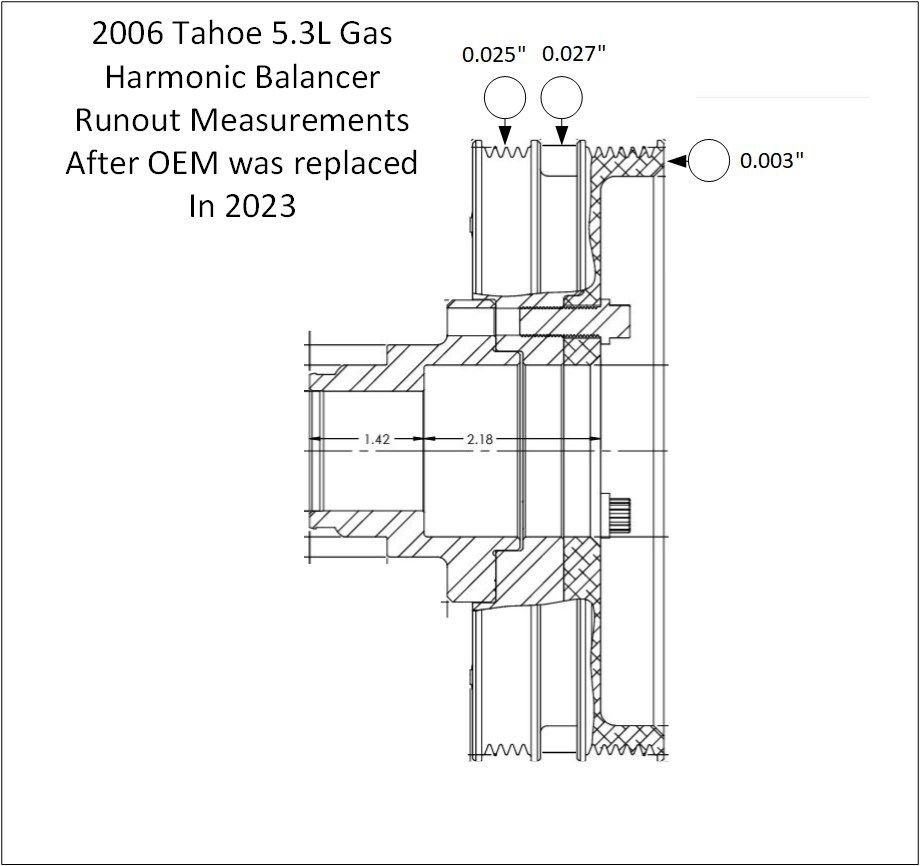

I'm a new member. I have the feeling that someone here might know how to uncover/find the harmonic balancer runout spec. for a Gen 3 LS - my motor is a LM7. 2006 Chevy Tahoe 5.3 - gas.
The best I can dig up is a reference to GM document #PIP4750E. This document list 0.4mm as an allowable runout but doesn't explicitly call out a 5.3 motor.
I just had the original replaced and I'm not really liking the runout because it is causing the AC pulley to bounce.
I measured the runout on the grooves and it is 0.025" or 0.63mm. See picture.
This was a Delco part so not sure buying a better one is possible. The mechanic said he would not be able to guarantee a runout but would replace it. Could be that one would have to purchase a performance damper that is not made with
rubber separating the parts. Some of the performance dampers have an "internal" damping element. Any ideas?

Even .4mm seems kind of alot. That's about .016".
If you have that much runout on a new damper, it's possible your crank is bent.

Yes, 15.7 mils seems like a lot. Note the very low runout in the lateral direction. I don't think the crank is bent.
