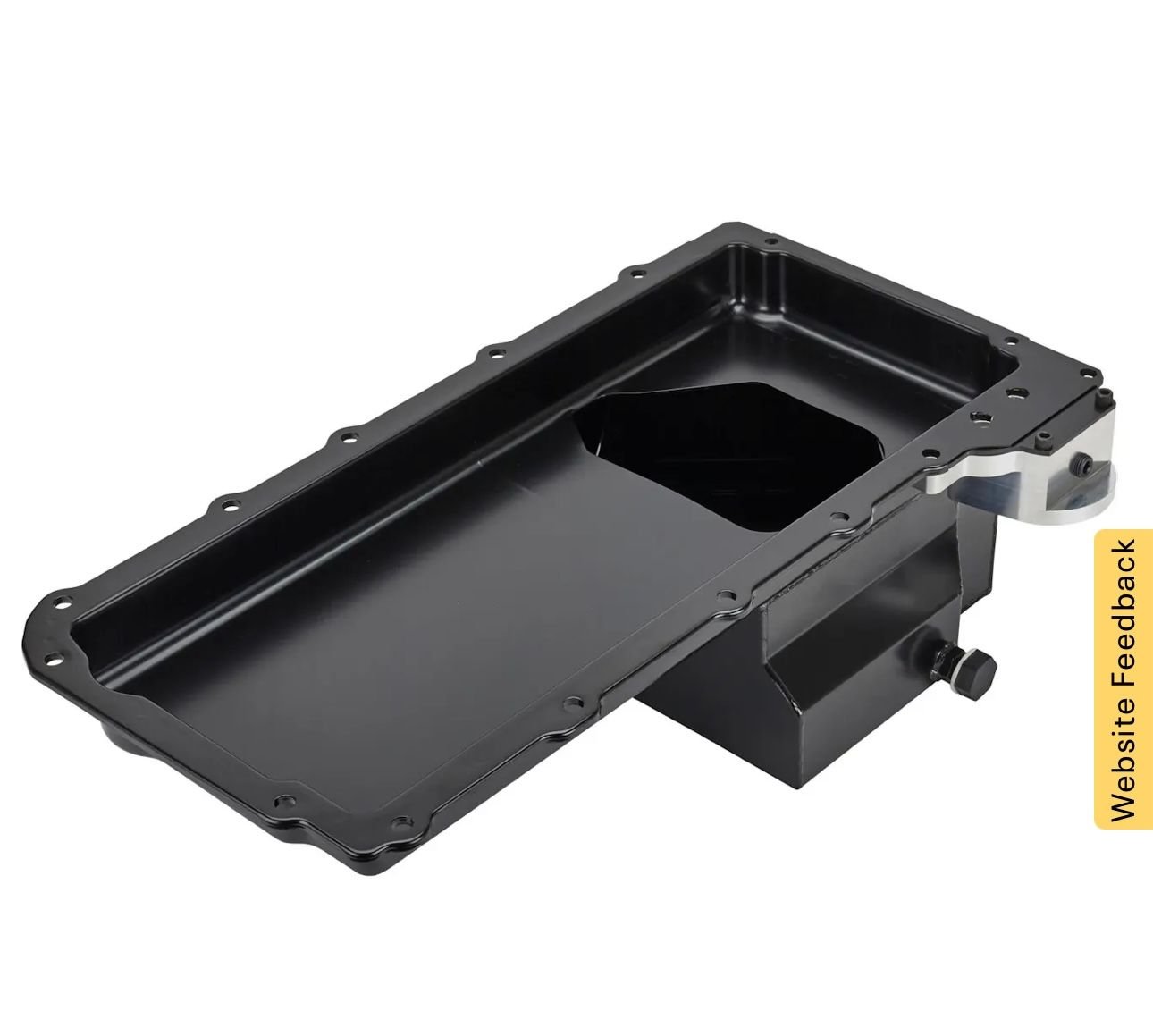

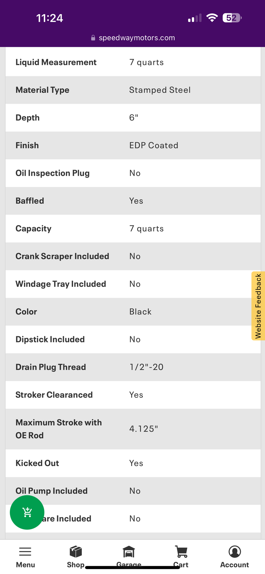

Anyone have any experience with the speedway oil pans?
I see they have one that includes the 1/4” NPT oil feed and -10AN return installed already. It looks like a nice unit, just wondering if any of you have run one?
I’d have to get the pickup tube and bolts from them as they’re proprietary. The only thing I would be nervous about is non gm/melling fitment of the aftermarket pickup tube to the melling pump going in the motor.

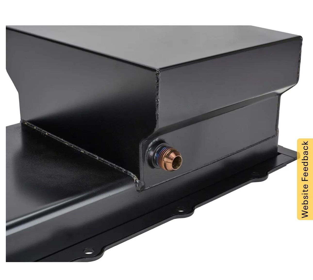

ok great thanks for the reply. I may just do a new off the shelf fbody pan in that case. As far as the turbo drain, I was planning on most likely doing a -10AN bulkhead fitting with locktite on the threads on the side of the pan higher than oil level. Would that suffice, or should I tap the hole in the pan and thread something in?

Funny you say that, I just did that exact thing to a new F-body pan. I just installed a -10 to NPT fitting directly above the drain plug, about a half inch down from the pan rail. Tapping it and using thread sealer makes possible leaks much less likely.

I ordered up the reman fbody pan with all the fixings, I’ll do that then, drill and tap 1/2” NPT into the pan with thread sealer and put a 1/2” npt to -10AN adapter on the outside.
