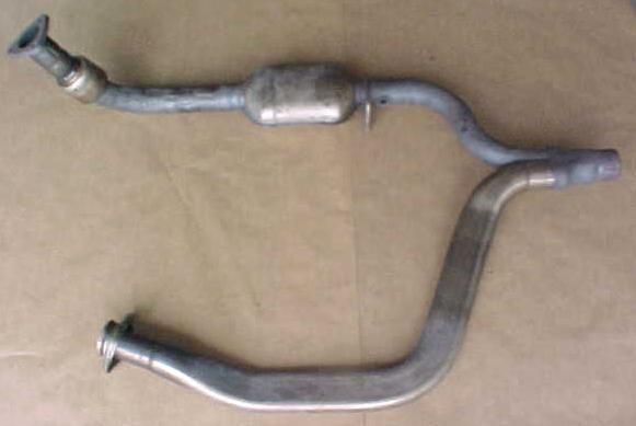

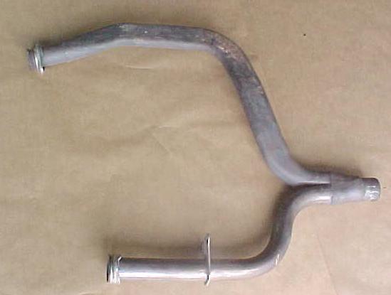

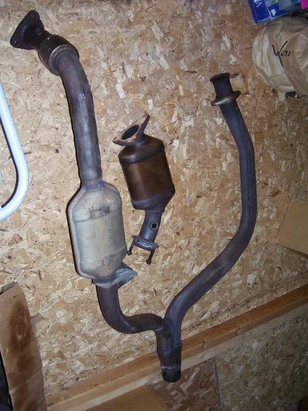

It does, in fact, sound like you have the "wrong" system on your car. The system you have described was not used on a 2000 model year (2000 to 2002 have modular cats that can be removed from the Y-pipe on both sides; 1998-'99 only uses a modular cat on the driver's side - passenger side is molded into the Y-pipe and further downstream as you have stated). Just to avoid any confusion, here are images of both systems...
This is the 1998-99 Y-pipe:
Here is the same version with the driver's side cat also pictured:
This is the 2000-02 Y-pipe:
And here is the complete 2000-02 version with both modular cats pictured:

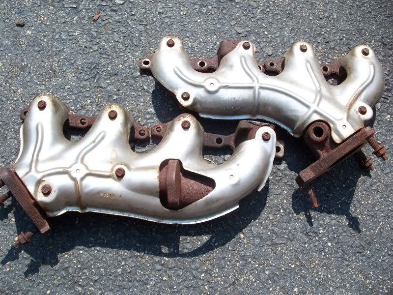

So yes, again, you are correct that your 2000 model year car would have originally come from the factory with two removeable cats that are bolted directly to the exhaust manifolds, and that the earlier 1998-99 system would have the passenger side cat farther downstream, molded into the Y-pipe (not removeable) and not closely connected to the manifolds. Furthermore, you could check your exhaust manifolds to see if you have the correct ones for your model year. Here are more images:
1998-1999 exhaust manifolds (rolled stainless):
2000-02 exhaust manifolds (cast iron, with the 2001+ version not being tapped for EGR but still having the provision as seen below):
I bought a 2000 LS1 Trans Am brand new, with 3 miles on it, and I can tell you that it definitely came with the later style exhaust components pictured above.
