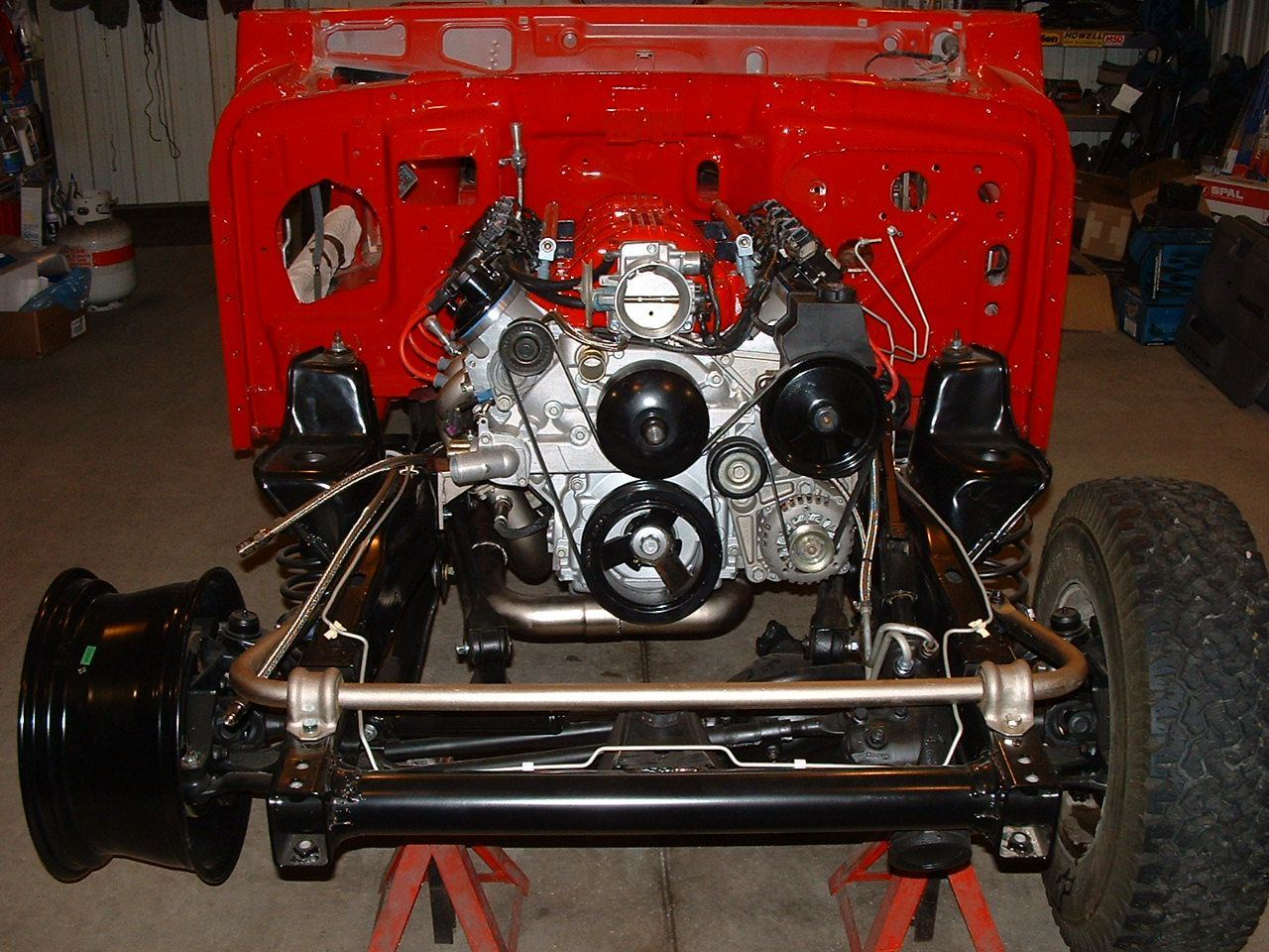

I have a 98 Wrangler with LS6/4L60E combo. Small cam so maybe 425 hp at the crank.
I used block hugger headers. For the same reason you have I had to route the left exhaust tube around the front of the oil pan and merge with the right exhaust tube then into a Flow master "Y". 2.5" inlet and 3" outlet. All mandrel bends to get around the oil pan. Then 3" all the way back to the bumper. Biggest/longest Dyno Max turbo muffler I could fit. Its been 15 years but I believe I used a 2009 Grand Cherokee V8 3" tail pipe. It's mandrel bent. Had mod it a bit to fit but it has worked well.
Pic.

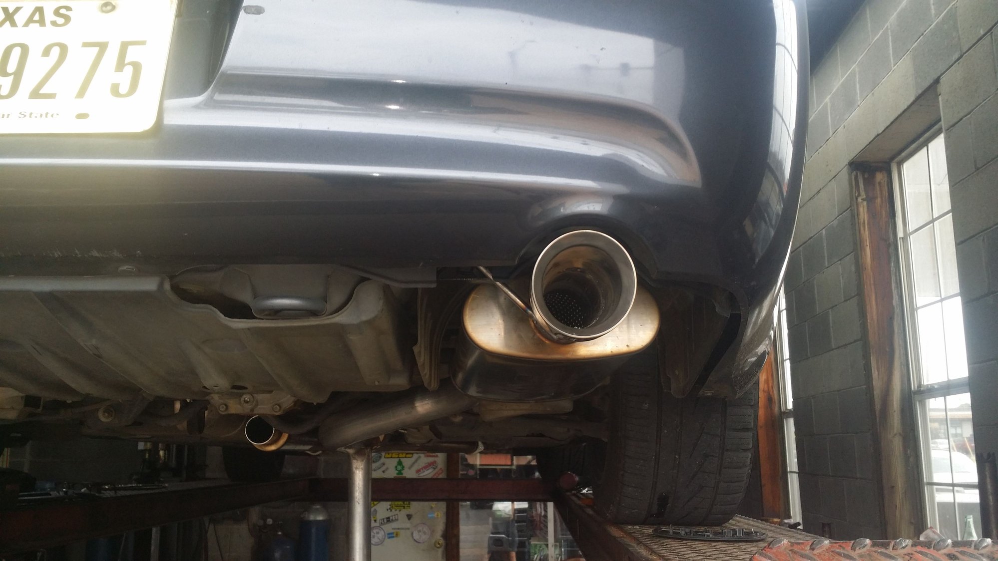

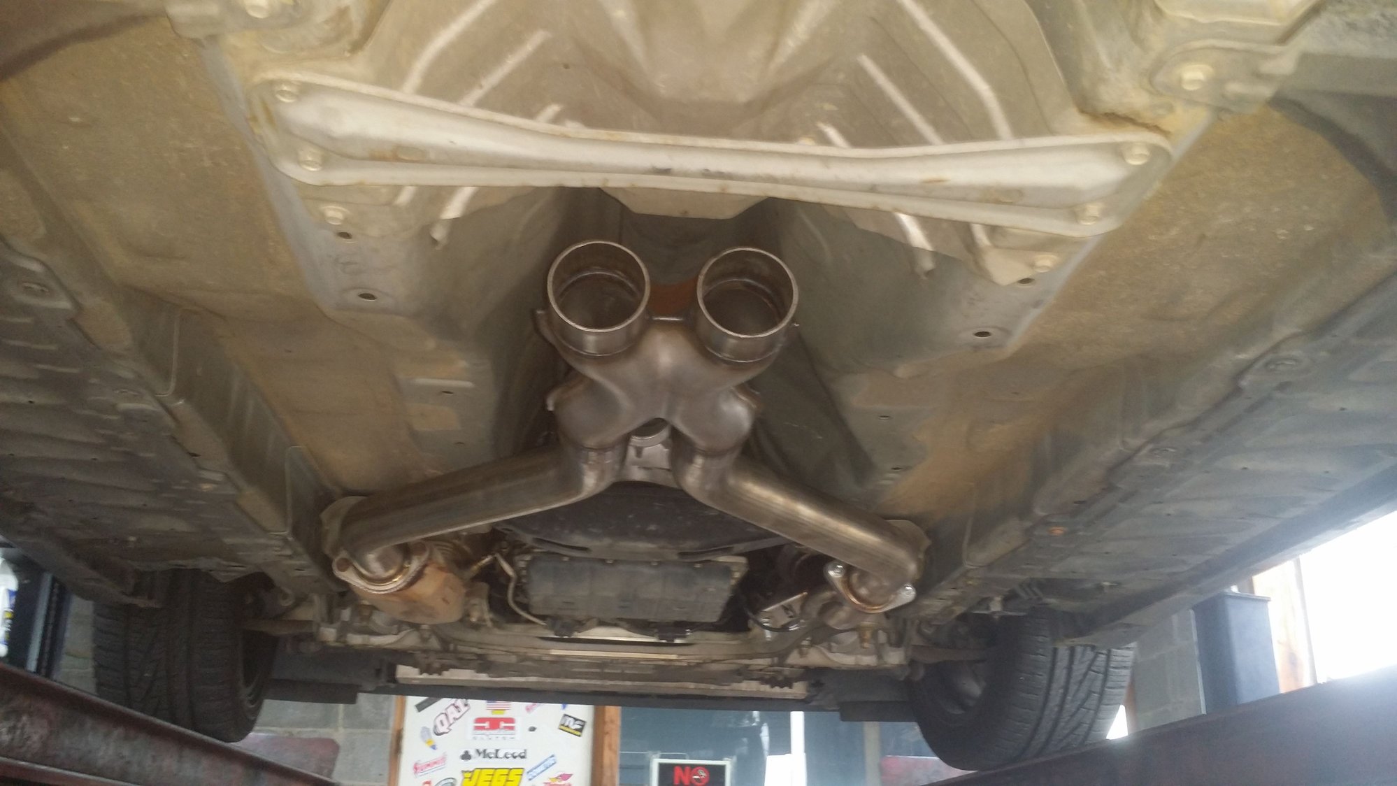

My 2011 M56S made 428 whp and 434 wtq through the stock exhaust manifolds with their close coupled factory cats and a 2.5" dual system with a X-pipe where the stock Y-pipe resided and 2.5" magnaflow magnapack mufflers where the resonators sat. Did the same exact exhaust on my 2007 G35 Sedans VQ35HR (7,800 rpm V6 FYI) as well except had headers and high flow cats. Ended up having to add 2 more magnaflow mufflers at the rear of the car to make that VQ somewhat quiet cruising and even then at WOT it was boarderline obnoxiously loud. Neither the V8 or V6 was restricted in anyway by the exhaust and both gained torque across the whole rpm range with the 2.5" dual systems.
G35

97 Express 350 OE 3" dual system complete with restrictive resonator.

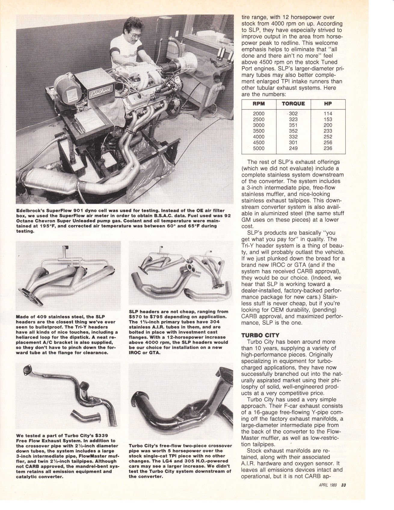

Would have been interesting to try on my 3rd gen that lost ~40 of its 423 hp with a 2.5" to single 3" Y-pipe. I think a lot is lost in those cars because of the weird angles the Y-pipe has to bend to clear various obstacles. Almost like GM designed that cars chassis and then remembered it needed an exhaust system. I had a used SLP system I found like new identical to the one in this article and a Random Technology catalytic converter on it because I had to stay with a single cat to pass visual emissions at the time. The catalytic converter probably cost some power and I know the catback did too. Picked up like 17 rwhp with an open 3" cutout.
