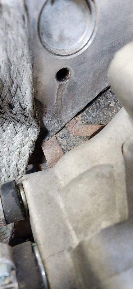

Hello LS1 Tech. I can't find anything about this threaded hole on the passenger side head. It has a small leak. 5.3 862 heads

Someone ran a bolt in too far and broke into the water jacket. If it was me I'd put a bolt in it with some thread sealer or a copper crush washer and it'll be fine.
Metric M10x1.5 thread pitch.

Ok cool. Was thinking that but wanted to make sure
thank you
Agree 100% here.
