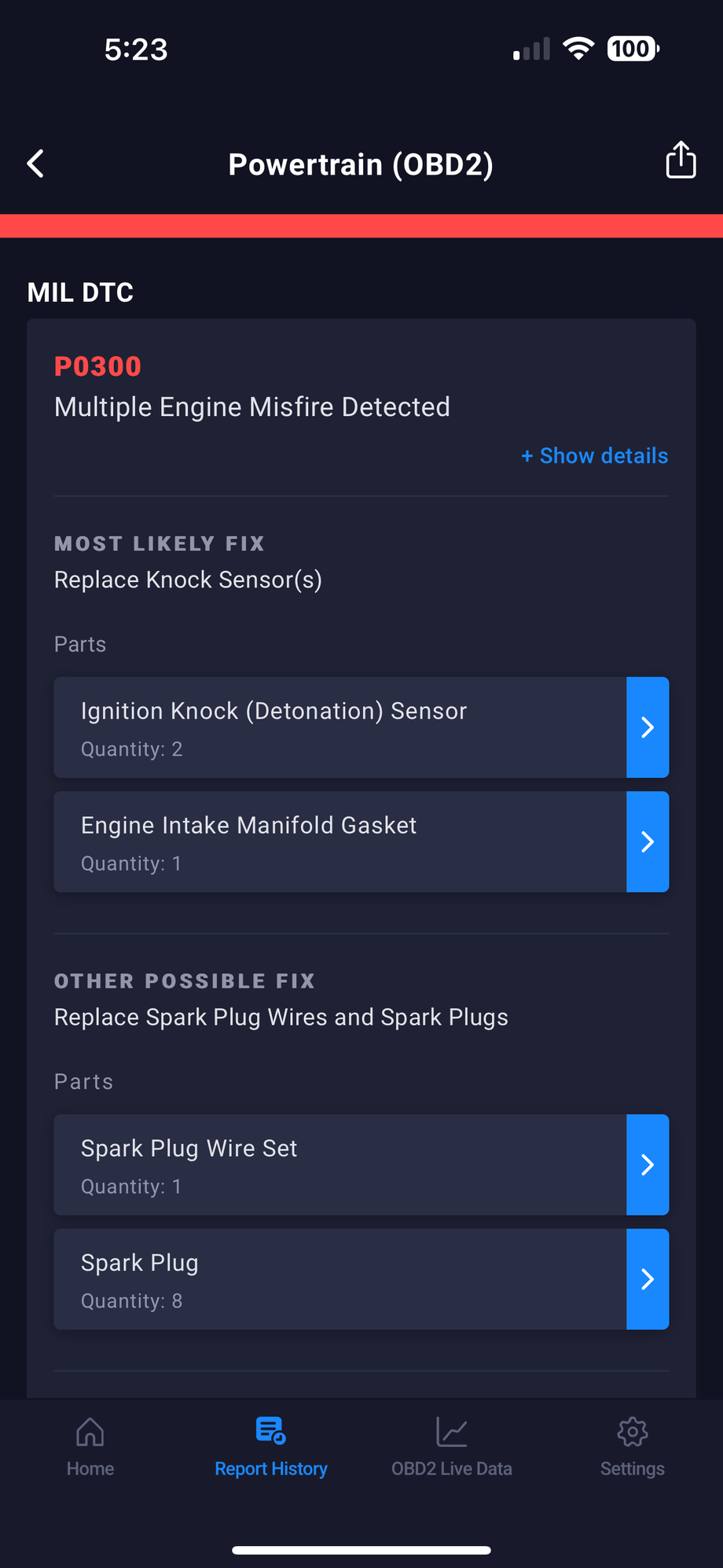

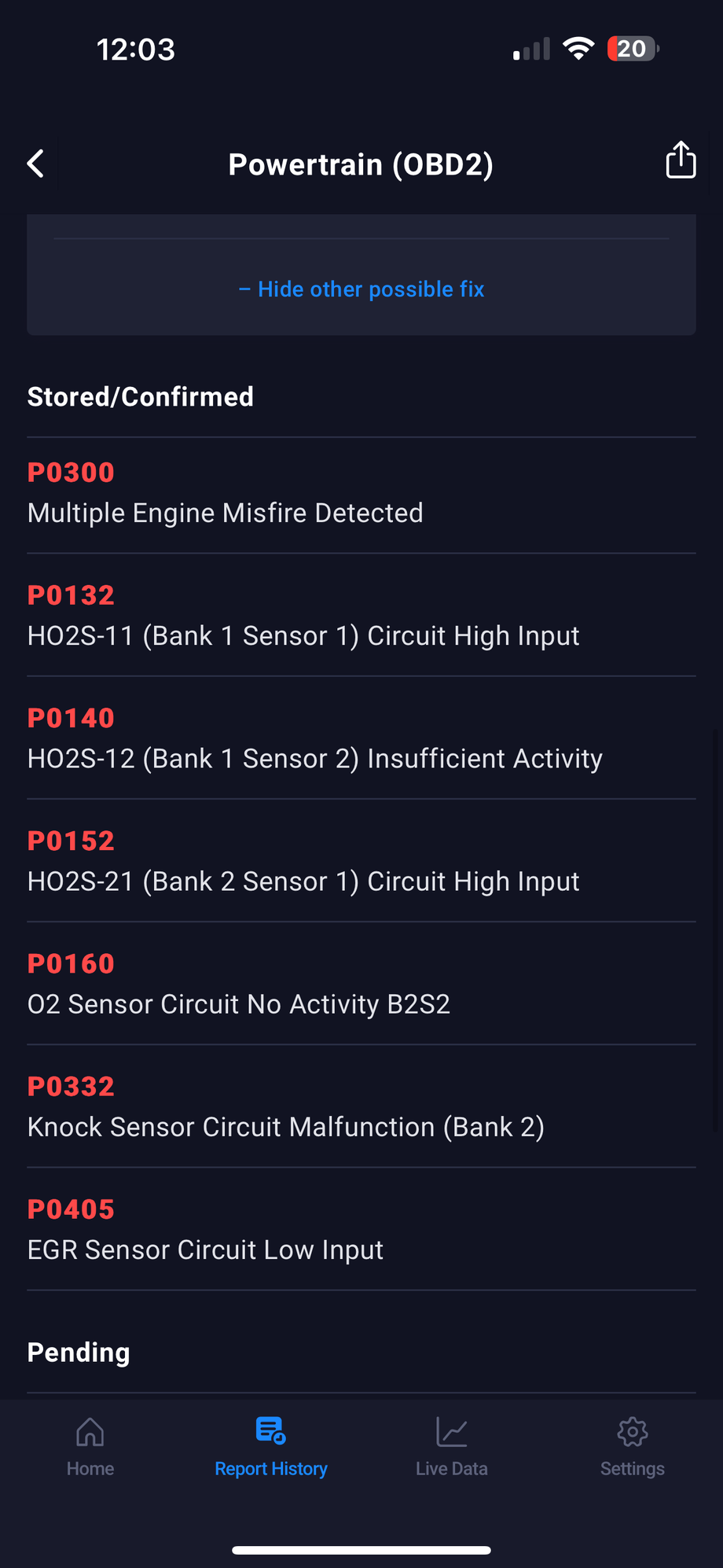

I got a 2000 Camaro z28 43,000 miles it came completely stock only thing I did was install long tube headers y pipe, msd spark plug wires, and ngk spark plugs it worked fine when I threw them on till like a month ago my car started backfiring when I accelerate fast I changed the spark plug wires(too stock) got new spark plugs and changed out the knock sensor cause I have a obd2 bt scanner that said it might need swapped out but it still backfiring any clues too why it would be doing that? the picture shows what the obd scanner says also the long tube headers did take away 2 02 sensors so I kinda figured that what some codes are.

If it worked fine for an extended period of time and then suddenly started backfiring, then the header install itself was not the problem. A tune will make it run better and maximize the gains, but this isn't going to solve a problem that occurred long after the modification in question.
The two codes related to the front O2 sensors are the ones I would worry most about (P0132 & P0152), as well as the P0300. There are several things that could be causing all of this, but tuning isn't going to solve it if the problem took a long time (post header install) to develop.

Looks like an ignition problem, first and foremost. Hard to say what exactly, butt since you've been strafing it with the parts machine gun, I'd look over all that VERY carefully.
"Bank x Sensor 1" O2 sensors are the ones the ECM uses to get feedback on the mixture. Once the ign sys is working right, clear the codes and see if those come back.
"Bank x Sensor 2" O2 sensors are the ones that give info about catalyst efficiency. If you have no cats, they're not gonna be very efficient. Best to just tune those out.
Not sure how the knock sensors are reported. Clearly in a 2000 engine there's no "bank 1" and "bank 2" those since they're both in the intake valley, although scanner software might translate the codes that way, in which case, "bank 2" is likely to mean the rear one, assuming exact factory wiring. Again, that may sort itself out once the ign sys is working right.
