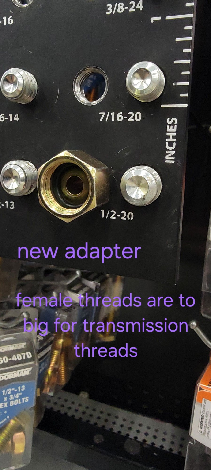

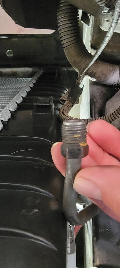

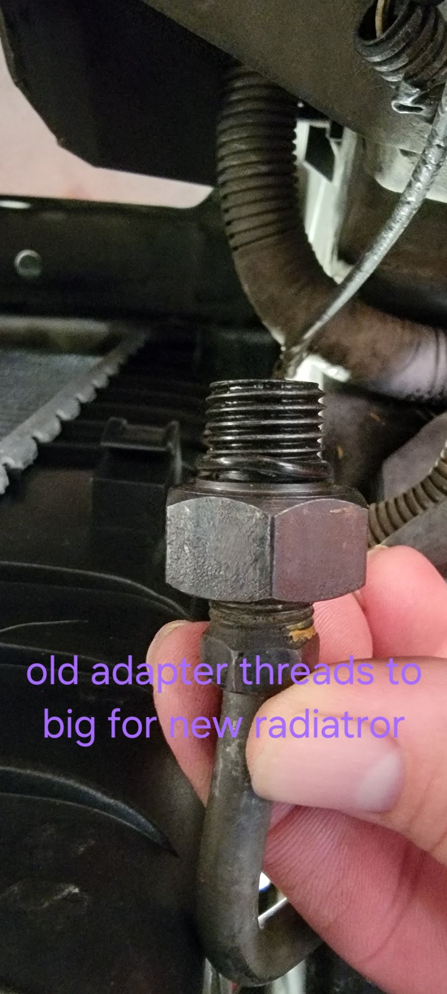

I need to replace the stock radiator on my 99 trans am. However the female thread adapter for the radiator is too big for the male threads for the transmission line. If I thread the transmission line directly to the radiator , it does not make a good seal. I bought the radiator from orileys since the last one lasted about 10 years. I bought two different brands, but they both have the same thread adapter. I have not been able to find the correct size adapter anywhere for this set up. I think I need 1/2 20 female to male adapter. Can you help or point me in the right direction?

Will the transmission line connect to the radiator with that adapter removed from the line? Usually the radiator has the correct adapter fitting already installed on the radiator or in a bag and you have to install them yourself.

From what I'm reading the adapter he is getting is wrong.
Try pulling the ones out of the old Radiator maybe..

Hi, I ended up welding the new and old adapter to create what I needed.
