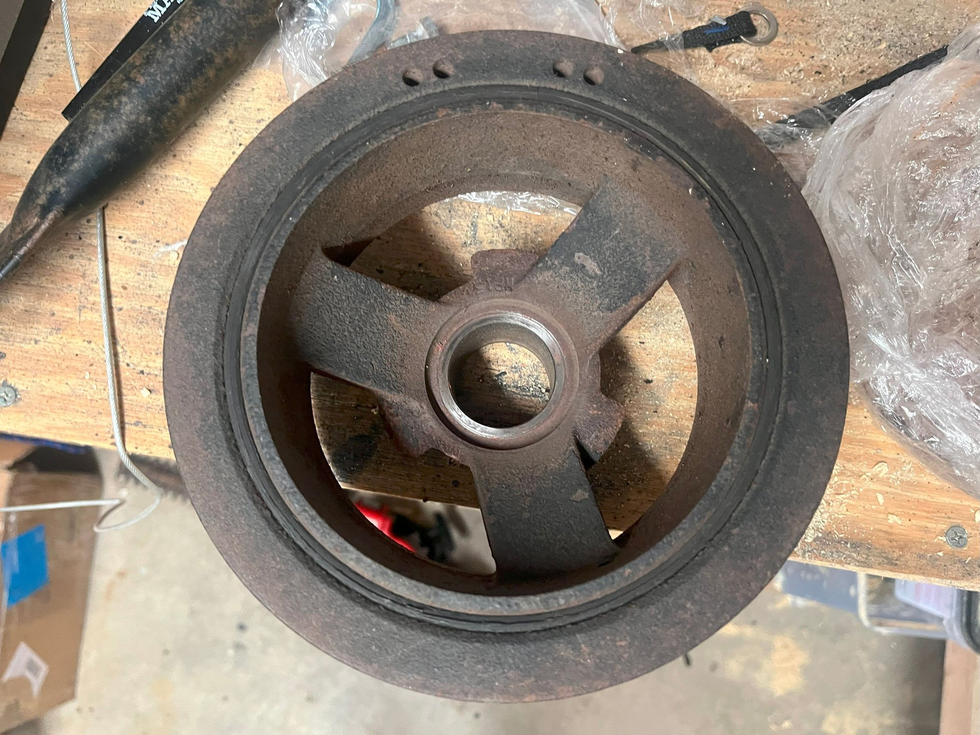

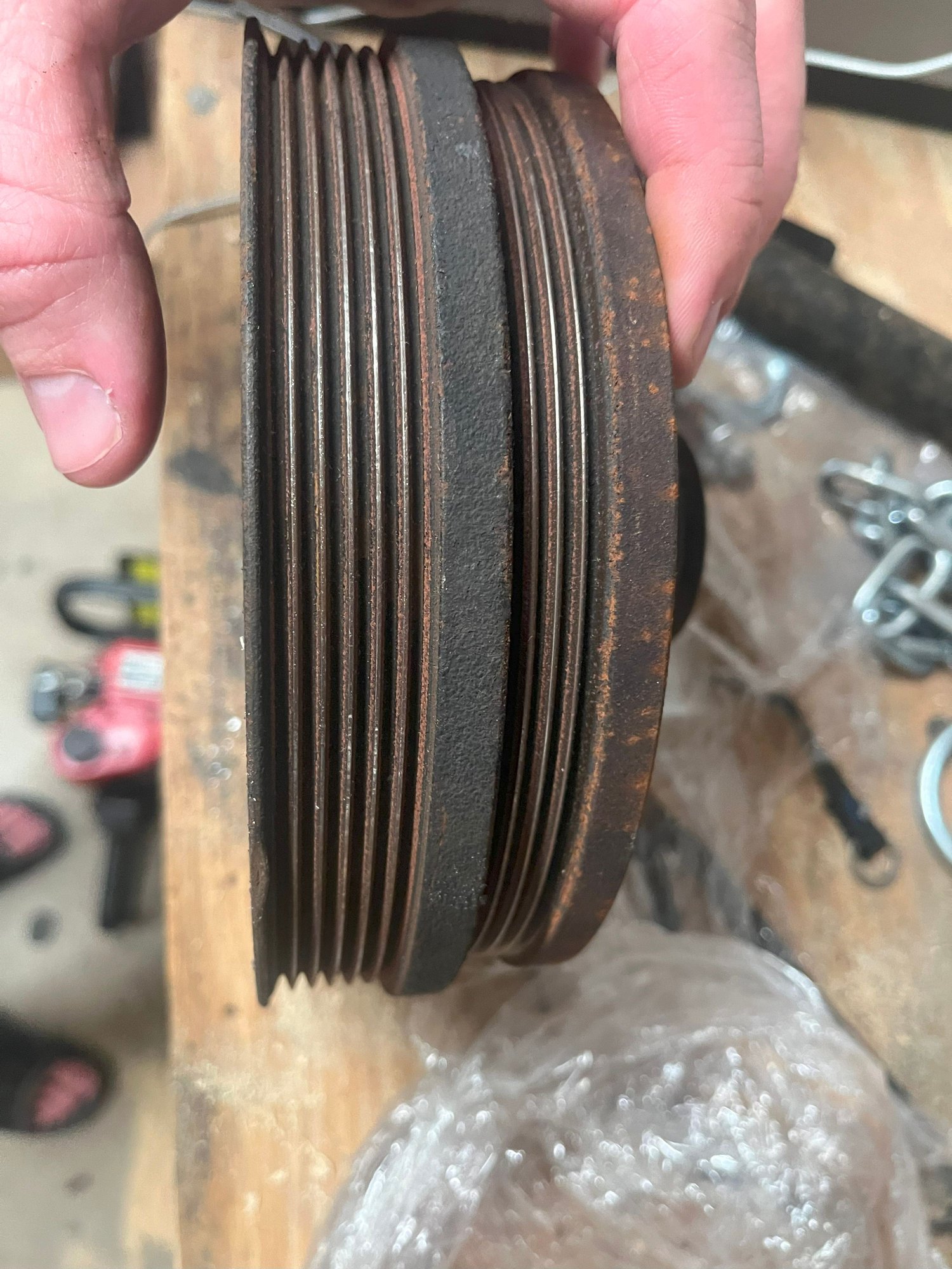

I believe this is probably a stock LS1 balancer but without any part numbers i can't say for certain

FWIW I think the f body and C5 had different balancers due to the serp. system being almost an inch closer to the front cover on the C5. So I think the only difference was the sleeve length.
