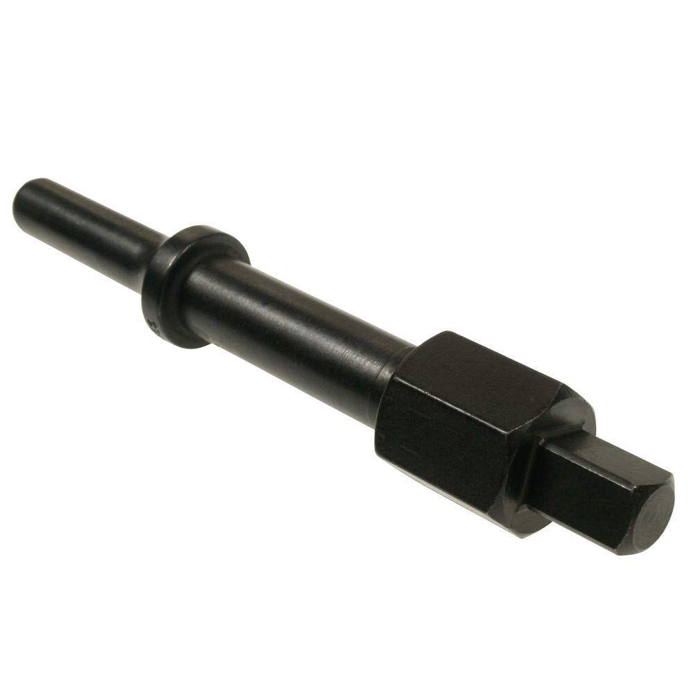

If worried can buy one of these: Have used it on junkyard engines that when through snow/salt with great results.
But worst come to worst... a Welder.
