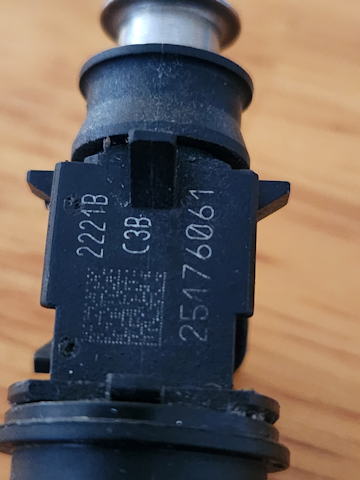

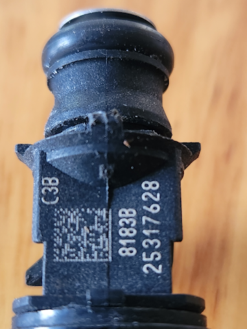

Multec is a trademark of Delphi. More specifically, of the Rochester Carburetor Division of Delphi. Delphi of course is the name of the company that was formed when GM spun off all of that back in the late 90s.

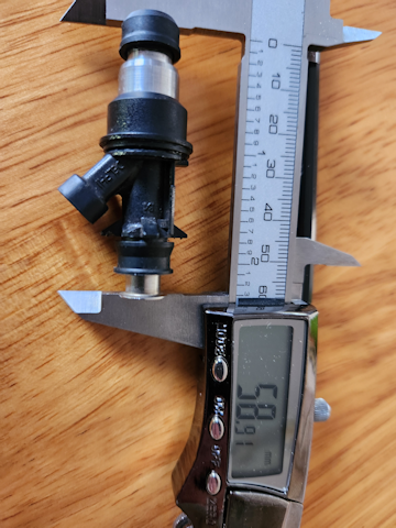

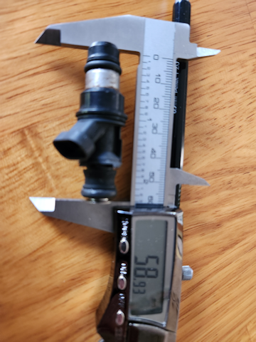

Here is a 4.8 / 5.3 / 6.0 injector.
Now here's the same thing for a 8.1 injector.

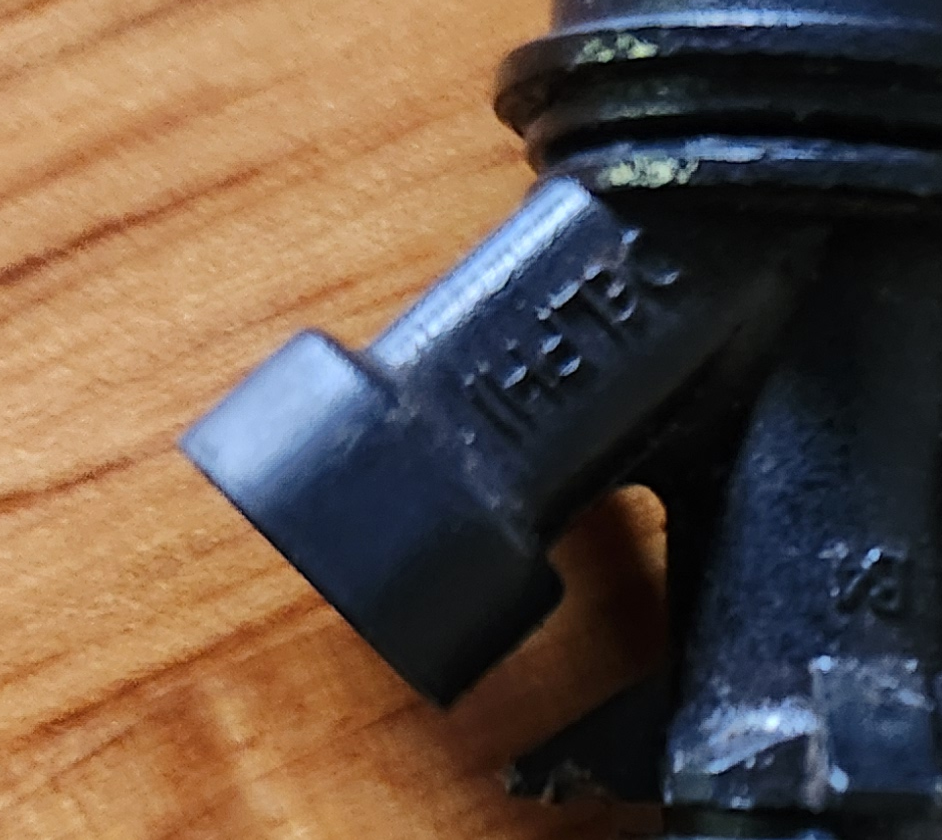

Here's the manufacturer. Same on both. You can probably somewhat see it in the length photos as well.
It's not that hard if you listen instead of argue.
