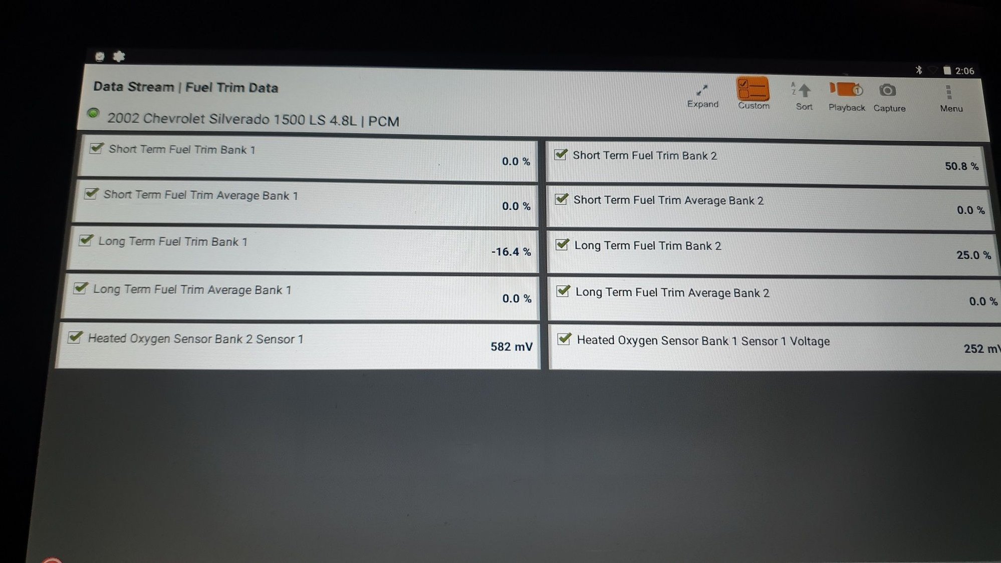

I hooked up a scanner, and you can see how the misfiring is mostly contained on the even bank:
Something else I noticed was that the fuel trims on Bank 2 were out by a mile when the misfiring occurred. They returned to normal when it stopped, matching bank 1.

Check for a small vacuum leak on the #2 bank intake area
