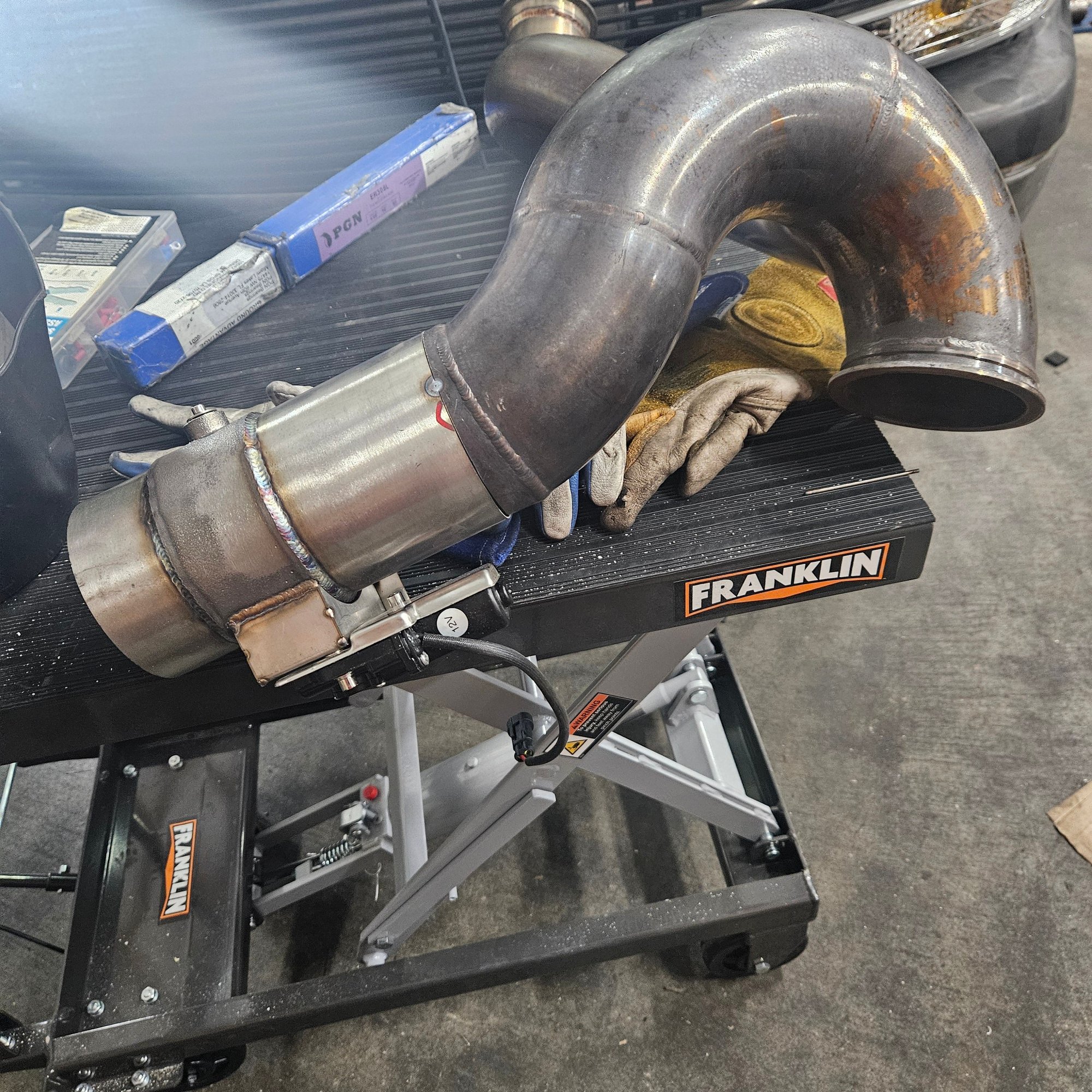

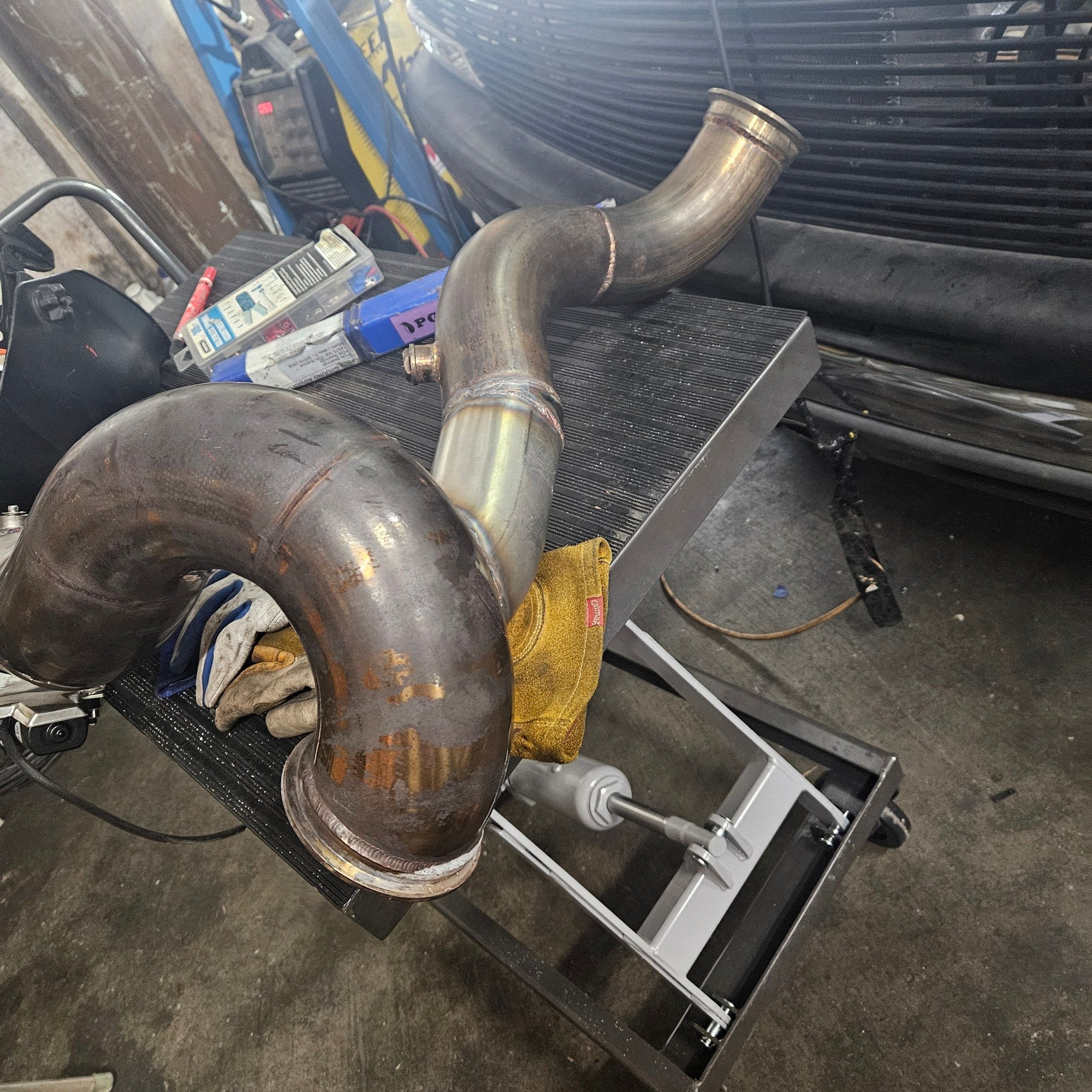

Holley is definitely the way to go man, that’s honestly the exact reason we ditched the P59 and went Holley. We tried switching OS’s around and it just kept giving us issues. It wasn’t happy with the 3 bar or the 210 injectors, and I couldn’t get it over 14 psi consistently. Now the truck does everything I need it to do.All the factory stuff inside still works too, oil pressure, speedo, temp gauge, RPM, fuel gauge, A/C, radiator fans, the whole 9 yards since I used an integrated harness. But since I used Holley too, I added second sensors to anything I wanted Holley to monitor. I have 2 temp sensors, 2 oil pressure sensors, and Holley monitors fuel pressure, trans line pressure, dome pressure, and controls the transmission coolers too.My boost vs dome is dead 1:1 too, so if I put 18 psi dome in it, it makes exactly 18 psi boost. It’s pretty dialed in now. Took a lot of adding little stuff here and there to finally get it exactly how I wanted it.Naturally I’m still adding stuff because we always want something else lol. The traction control is mainly for all these newer Edge F150s and cars running around with factory traction control. From a roll I’ll give them all they can handle, but from a dig the truck just turns into a smoke show.
4
4" to 3" split pipe
4
4" cutout that we welded to the end to go out the fender, it was only tacked here but it welded out and wrapped with exhaust wrap and painted with high temperature black silicone spray paint.
