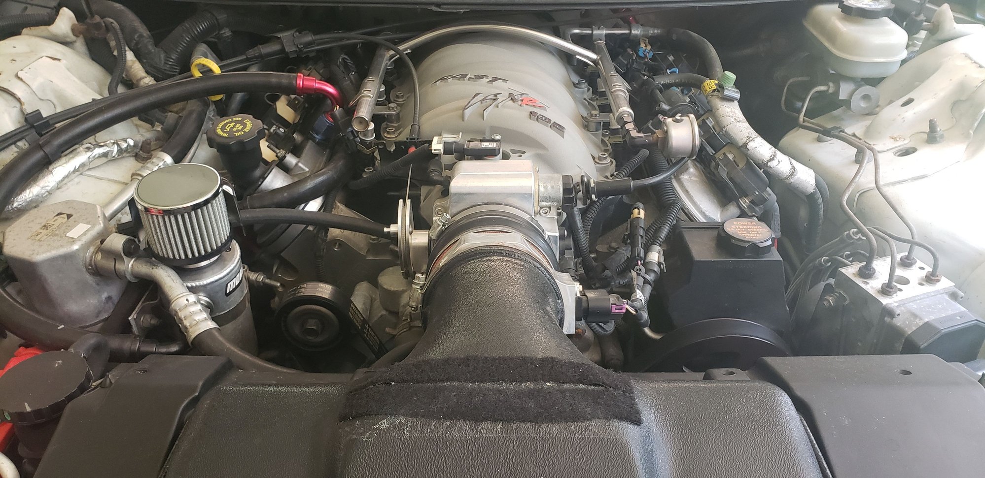

Ok guys I need some help.
My catch can fills completely with oil in probably 20 minutes of driving. (NA 383 LS1, Heads/Cam, Intake)
I have the dirty side coming off the drivers side PCV valve.. routed to the lower port on the EliteEngineering can, and I have the top port connected to the Fast Intake behind the throttle body. Currently have one port blocked and rear port with a small breather for fresh air on passenger valve cover.
Can anyone help me account for why it’s filling like this? No significant blow by with the oil cap removed etc. It didn’t matter which way I had the lines connected at the can it fills up WAY fast.

The plumbing is backwards: top port is inlet, side port to manifold. Did you just install it or is this a new problem?

no, it was a mess when I got it. It didn’t even have a hose connected to the driver side. So I’m trying to get it established.
I have, however, hooked it up both ways and it fills the catch can either way
but it runs great. It doesn’t smoke unless the catch can fills up.. and if I pull the fuel cap off, there’s just very minimal vapor floats out of it
