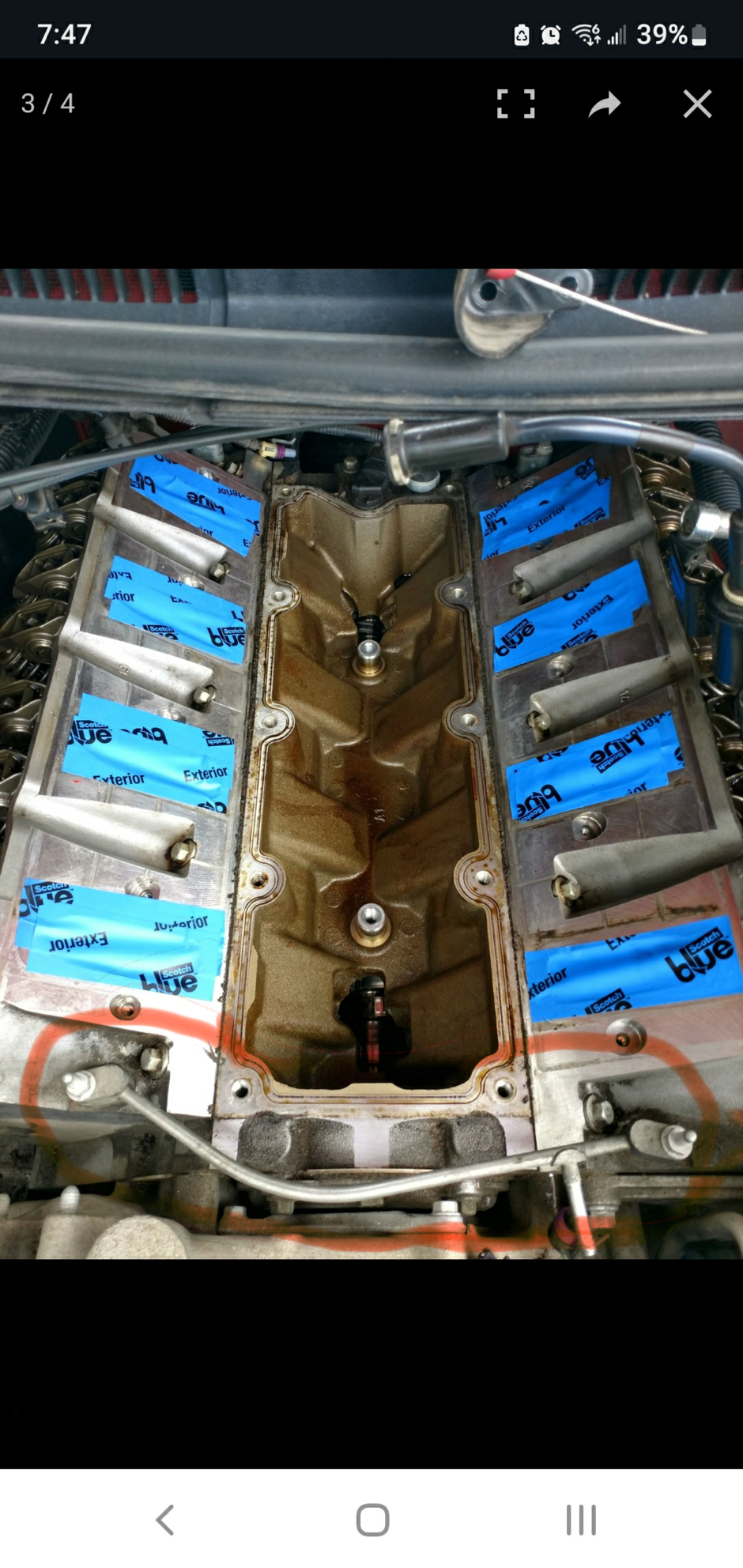

Old Apr 26, 2025 | 08:09 PM
jeff dunnington's Avatar
Joined: Apr 2025
New to the group. thx in advance for all the info
Have a 98 c5
Just did the ls6 valley pan swap. had to notch the block as discrided.. Used a multi purpose tool to make the cut and worked great..
have a question about the block vent tubes (see pic). can these now be deleted. I have deleted the air pump.
Hoping to get alot of assembly done tomorrow.
traveled way down the rabbit hole on this one.
Old Apr 27, 2025 | 07:39 AM
LS1Formulation's Avatar
Posts: 3,931
Likes: 1,162
From: Grand Rapids, Michigan
No, you cannot delete those. Those have nothing to do with the PCV system, they are steam ports to allow air pockets/bubbles to escape from the cooling system.
Old Apr 27, 2025 | 07:48 AM
Doug G's Avatar
Joined: Aug 2010
Posts: 4,472
Likes: 198
From: Harford Co. Maryland
IF you don't like the look of the stock steam vent, they do make some nice aftermarket ones....just sayin'
Old Apr 27, 2025 | 07:58 AM
5.7stroker's Avatar
iTrader: (36)
Joined: Apr 2009
Posts: 2,364
Likes: 278
From: OH
Look into the jegs 555- 53550 four port steam vent kit. It has more compatibility with the various intake offerings compared to the hardline kits.
Old Apr 27, 2025 | 10:30 AM
Posts: 22,301
Likes: 3,625
Originally Posted by jeff dunnington
Have a question about the block vent tubes (see pic). can these now be deleted. I have deleted the air pump
As has been mentioned, you need the steam vents for the cooling system to function right. They have NOTHING to do with the air pump.
They're part of the cooling system.
