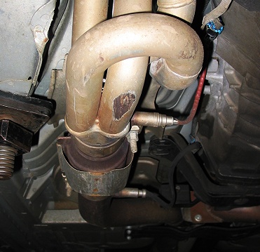

SLP are a lot harder = true
[EDIT] they hang really low, and must have the worst clearance of any headers. My first and so far only expensive do-over... If given another chance I think I'd go with QTP or Jet Hot.
