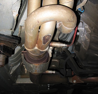

The cats will make the LTs and LM sound better, and enable you to pass a sniffer test if required in your state. I have this exact set up, and I love the LM, but would get other headers if I had it to do over again. They hang way to low. I think QTP and TD is my next exhaust set up.

well the slp headers take away about 2" of ground clearance theirselves minus another inch or two, your headers will be on the ground, literally every time you hit the smallest bump. talk about pissed off my buddy rubbed a hole in his im glad he bought his first, i'm gettin pacesetter, what he has now much easier to install (less cussing)

i just finished installing my long tube SLPheaders,(they are very low) you cant lower ur car after installing them,otherwise ull have alot of problem driving ur car.

Lowering and SLP LT's do not go together well at all. Humble speed bumps will be like Mt Everest
