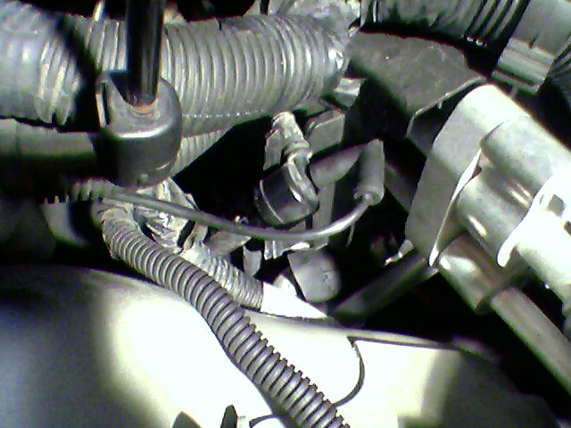

i just did the !wire mod, and it looks awesome....but it calls for you to take off a small vacuum hose about 8 inches to the right of the PCM
here is the picture:
so what does that do? the nipple on the end broke off, so i need to buy another one asap since i have work in the morning, and i dont know what its for and i dont want to go driving 30+ miles to work in the morning if its something important....
what is it?

heres a better pic of it

connects into hvac and goes to back of manifold. Also works with AIR system.

but will a generic T fitting from Pep Boys or somewhere work to replace it?

Yes it will. That vacuum hose goes to the front of the car where the vacuum canister is located. This vacuum canister acts as a cushion for when you click the A/C from vent to defrost etc.

actually its a check valve and Advance has it for 3.48
