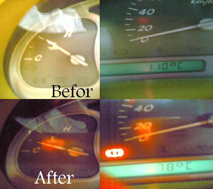

The problem from the Catback !!! I have the stock one
look with catback and without it (open heders) ...
