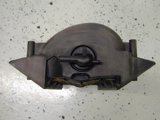

ls6 intake has a flat bottom

Here's the LS6 intake:
Here's the LS1 intake:

All LS6 intakes have the flat bottom and all LS1 intakes don't.
Some Vette's had LS1 intakes without EGR.
SLP also sells an LS6 intake with the EGR provision.
So it's hard to tell which it is when the intake is on the car.
And of course you can check the part number ...

the LS6's plastic ribs on the bottom are all squared off, I think the LS1's are kind of slanted
