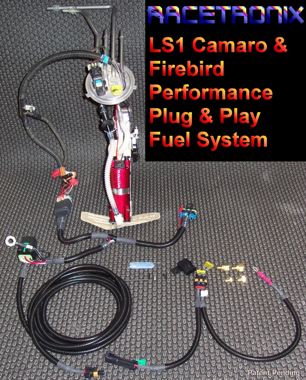

Hey, 98 owners. I'm sure some of you guys have used this kit and or run into this problem. I have 98 specific plug n play kit that came with no sock. I can't get one and the vendor insists that a factory 98 sock will work but the openings are different. What can I do to resolve this issue? What have you guys used?

Yeah, I did all of that nonsense the 1st time around. This time the whole module was ordered but it didn't come with a sock. It's this system
http://www.racetronix.com/product/RX.../Dcp_0545a.jpg

You can purchase a new GM sock from Thunder Racing or use our replacement.
The instructions that come with the F98-FPA detail the installation of the GM sock.

O.k. I need to check all of this for myself. A friend of mine bought the kit, it had no sock and I've been banging my head ever since I was asked to try to find a resolution. Thanks, I'll get the install instructions. Just out of curiosity though, What mods need to be done to the factory sock so it'll work? It may be helpful if someone else runs across this post.

The only modification is to pull a metal piece out of the plastic collar and it slides right onto the pump.
